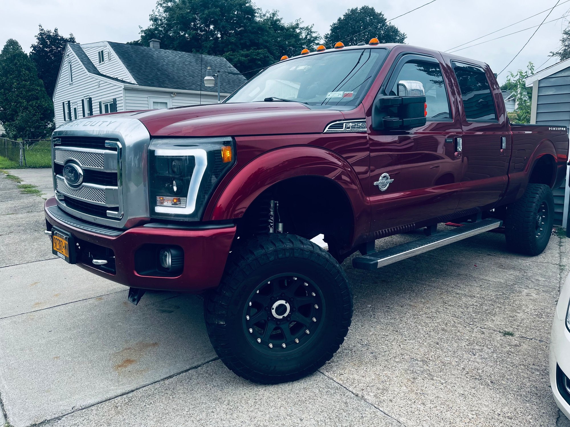

Hi all, I have some electrical issues that have gotten worse in the 11 months that I’ve owned this truck. I bought an extended warranty that should cover all of the issues, but my local Ford dealership wants to charge me $340-550 for diagnosis, but if you guys and girls could steer me in the right direction, I could figure it out myself. I do strongly believe I need a new PCM vs having bad wiring harness issues, but I’d like to know more instead of throwing money at parts. I sold my OBD2 scanner when I retired from wrenching in the late 90’s so I have nothing else besides my knowledge to work with, but this one has me stumped. Here is the list of issues;
*Window switch doesn’t auto up and when it does, it goes all the way up and immediately goes back down halfway, intermittently. Plus it also does it when I manually use the window button.
*Blinkers in side view mirrors stopped working.
*Side view mirrors heaters don’t work.
*Battery leaking.
*Radio shuts off when driving and sometimes comes back in by itself.
*Drivers seat stopped working.
*Rear park aid/beep works intermittently.
*Service fast track, antilock and slippery when wet lights turn on and go off within a few seconds.
I sincerely appreciate any help you can and will give to me.
