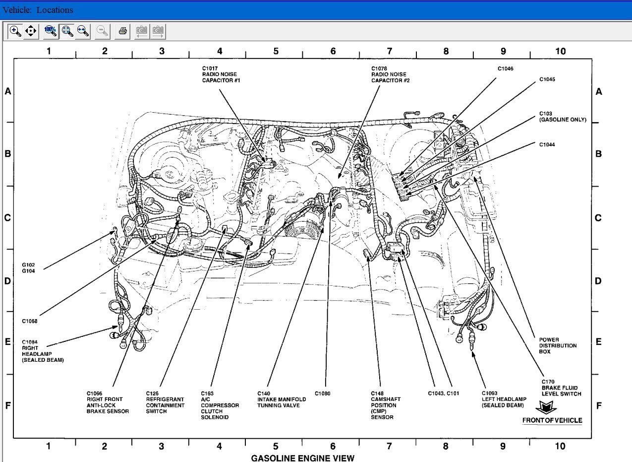

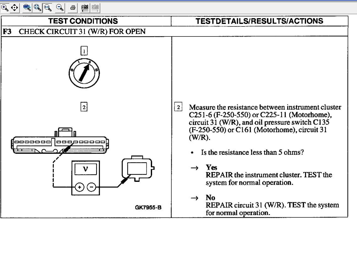

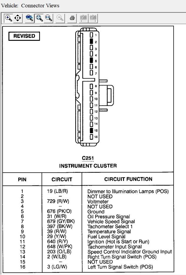

Pinpoint F shown below:

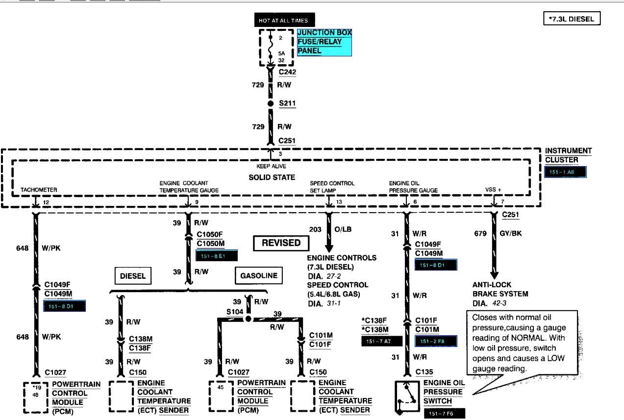

On circuit 31, locate C1049F and C1049M shown below.
Locate C101F and C101M below:
Follow C101 to get to the pressure switch (C135).
