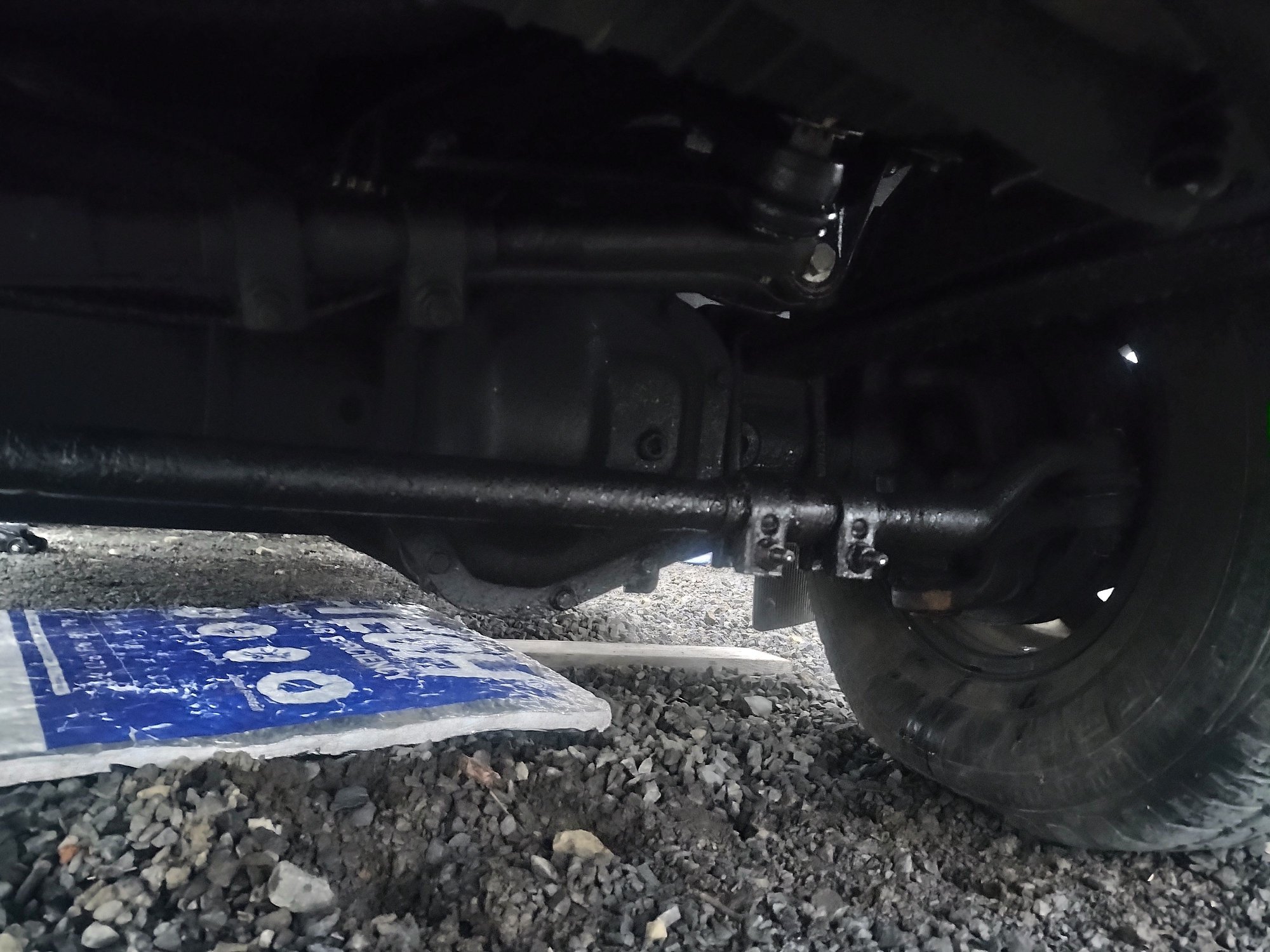

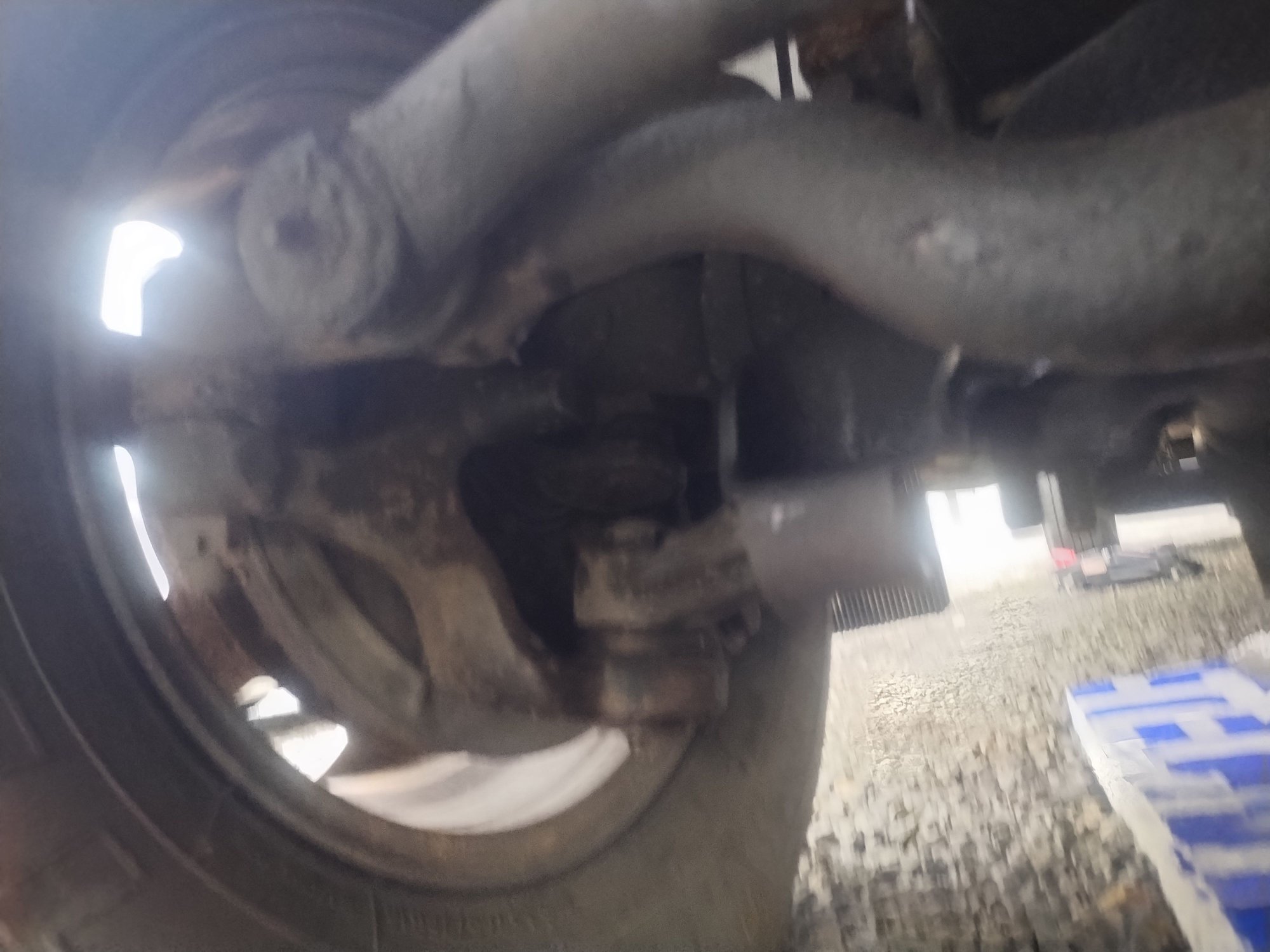

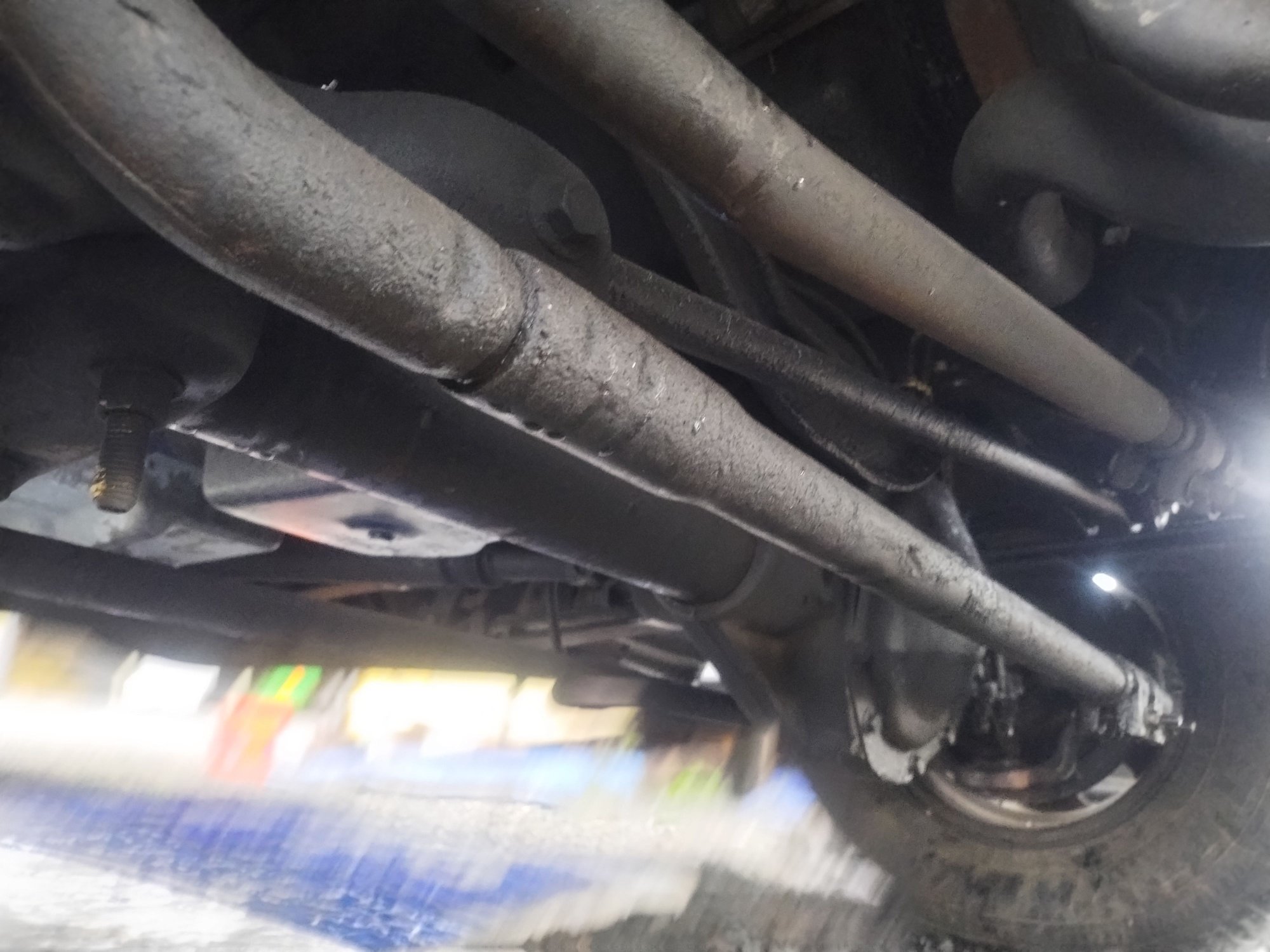

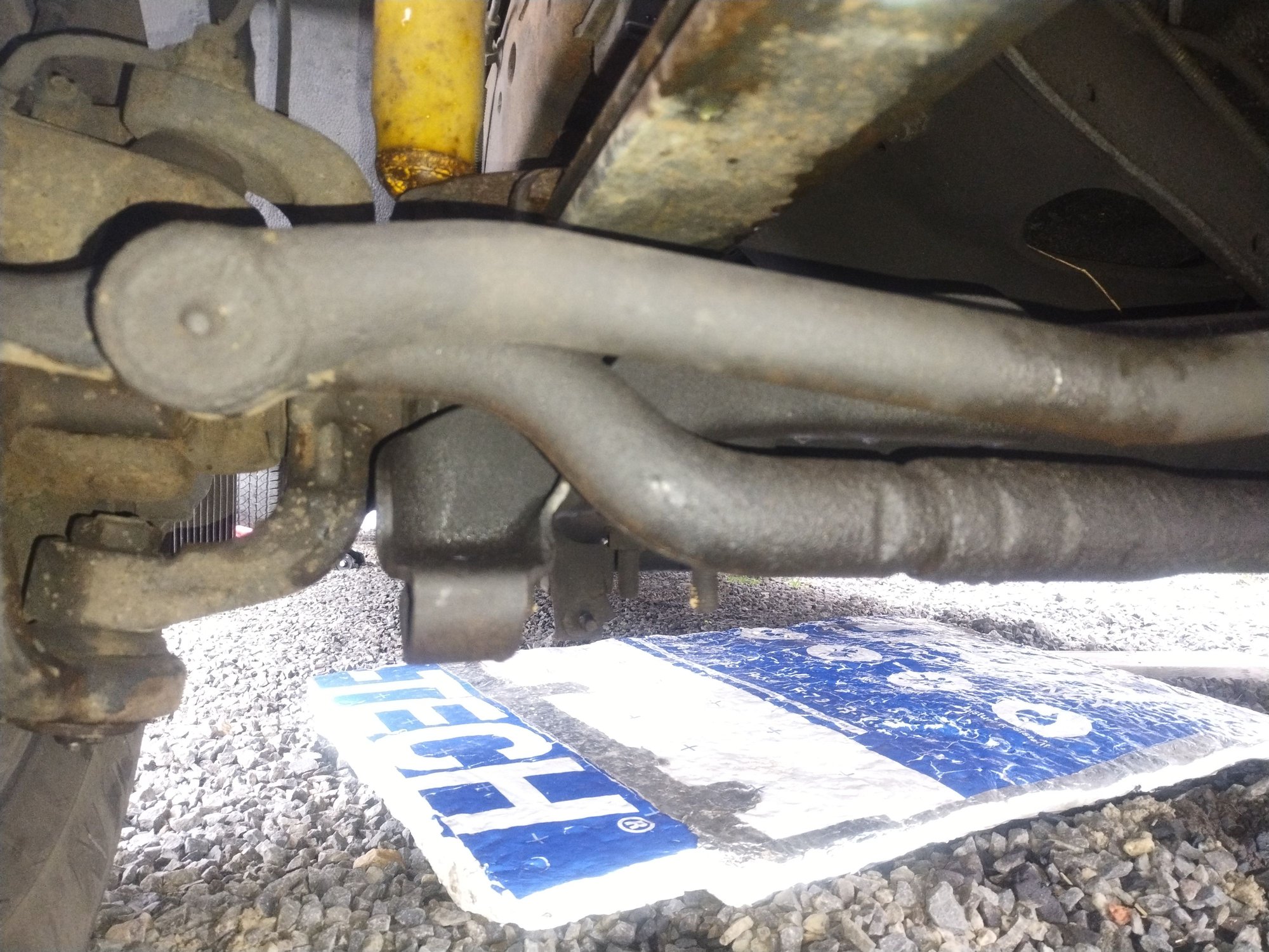

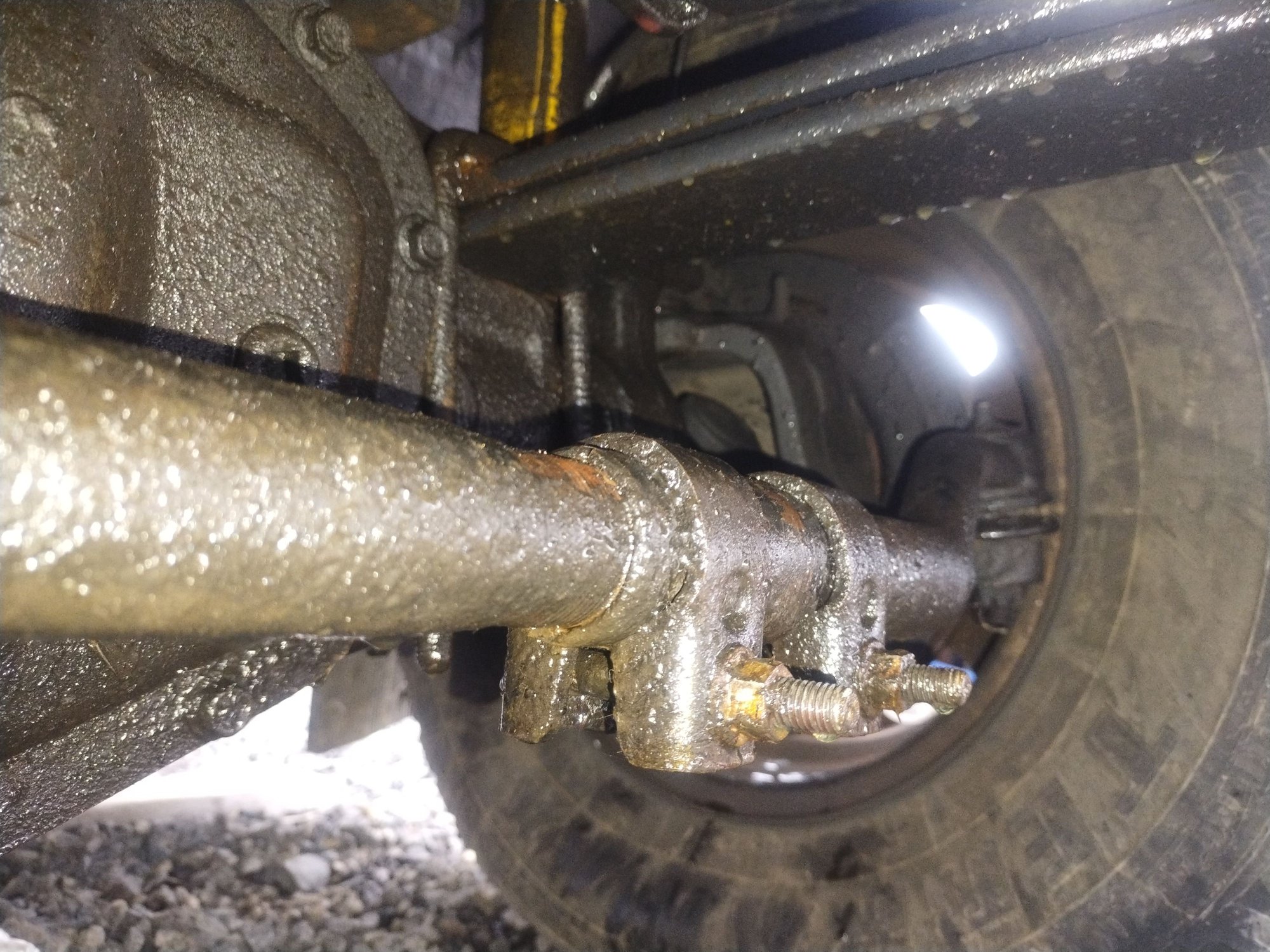

As you may already know , you have some BIG expensive problems.
That bent steering rod will need to be replaced. Then alignment will need to be performed.
Right now I doubt both front wheels are pointing in the same direction
Can't see the radiator support you mention.
We can't cry over spilled milk, so hope you can handle all the work involved.

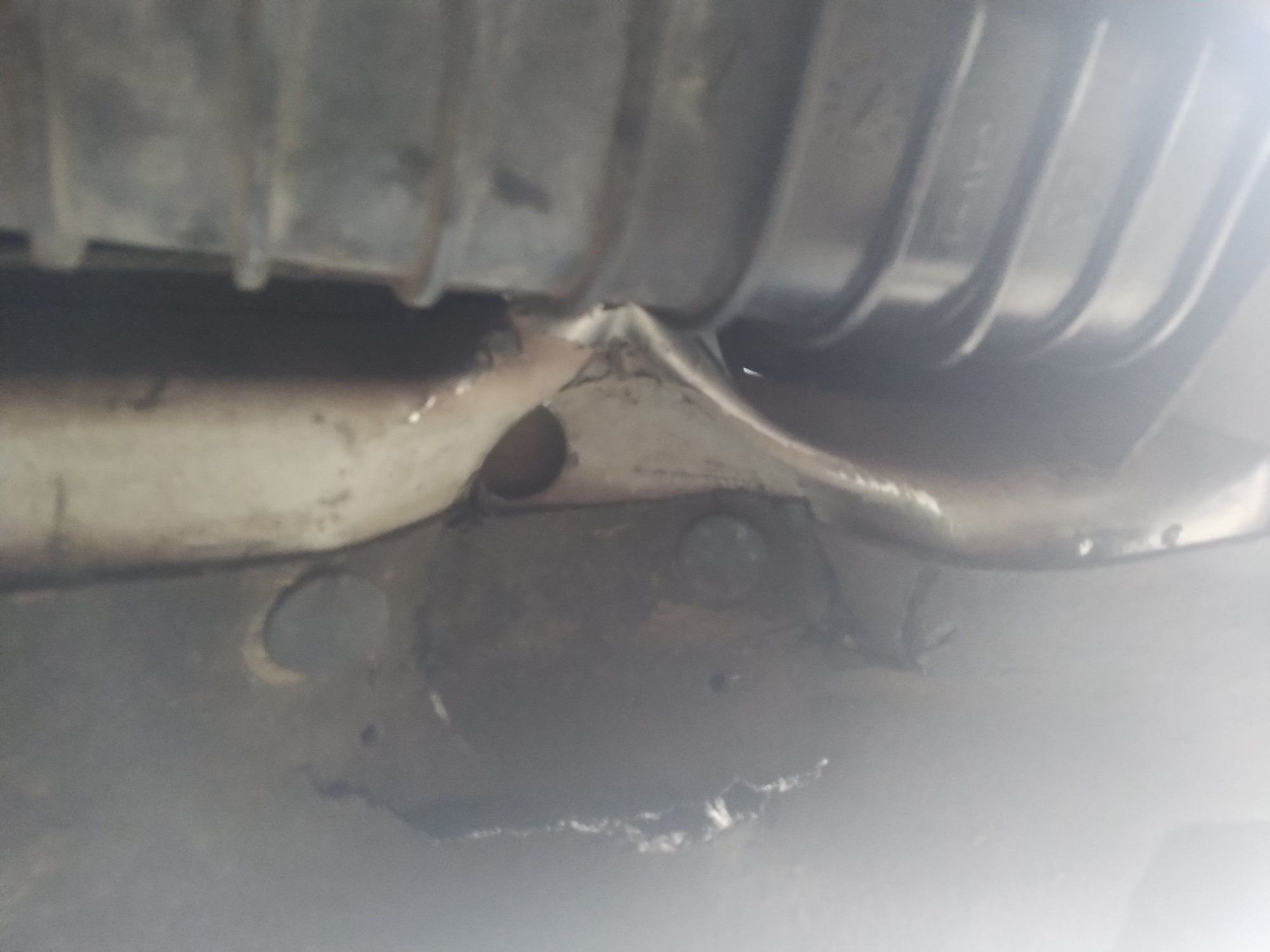

Thank you for the help/advice. I defiently have big problems, this is one hell of a **** up lol. I already needed a front end alignment, and i can figure out how to do the steering rod. Both wheels are pointing straight, but still.
Radiator support is in the last picture. Also called radiator core support. There should be like 14 pics? I put the pic of the core support below, just in case.
I'll have to figure out how to do all the work, I dont got another choice. I can oder most parts off rockauto, and pull parts from the junkyard.
I wish I had the money to just have a shop do it, but I don't.
The rear wheels are on. As I was putting the rear wheels on (I had just finished working on it), I lowered the jack to put the second rear wheel down and thats when it slipped forward off the front jack stands. I had no idea it could even do that, I thought the jack stands werent something it could fall off of lol.
Question for ya. Ive been talking to my friends and another guy on a diffrent forum, can I just bend the core support back into shape and call it good enough? I know its not ideal, but I doubt I have the skill to take apart the entire front end on my own, and the core support is spot welded or riveted on. I know I defiently need a new radiator. Im also not sure how to check if the tie rods are bent, and also whatever else I could have ****ed up.
