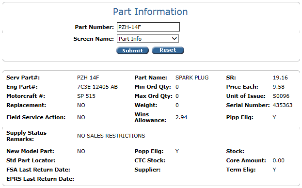

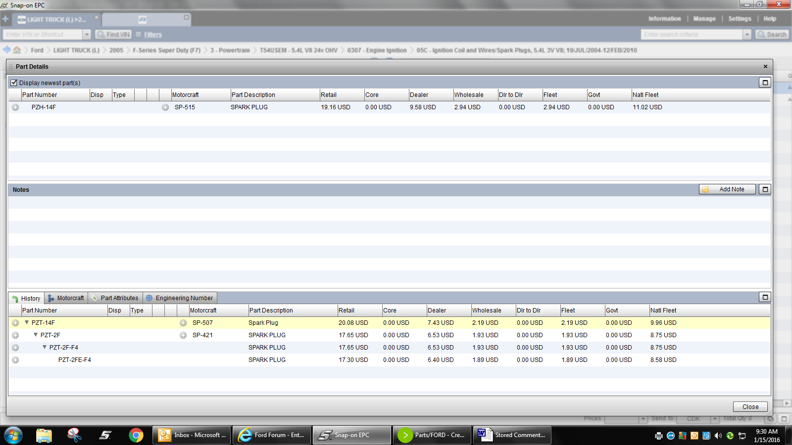

I will say that it is not uncommon for parts employees to not know about class action lawsuits regarding a part or car, unless they have done the research themselves. I see that you bought the SP511 but according to my catalogue, which you can see in the attachments your vehicle calls for the SP515. The SP511 is a completely different plug and will probably not work correctly. SP511 is also an old part number, it supersedes to an SP518.
I would suggest returning the SP511 plugs and buying the correct ones, SP515. We have them available here: #PZH14F: SPARK PLUG. The part number listed is PZH14F which is a service part number for SP515 which you can also see in the attachments. If you decide to buy the 8 plugs from us I would be happy to offer you a bit of a shipping discount, just use the coupon code FORDFORUMS during checkout. The coupon will be valid until the end of January.

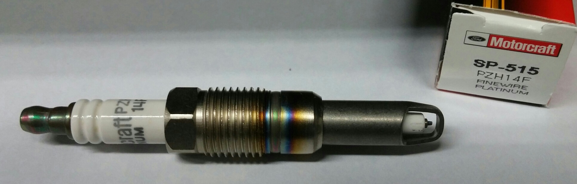

I have also attached a photo of the SP515 so you can see exactly what you would be buying from us or any other retailer that is selling SP515.

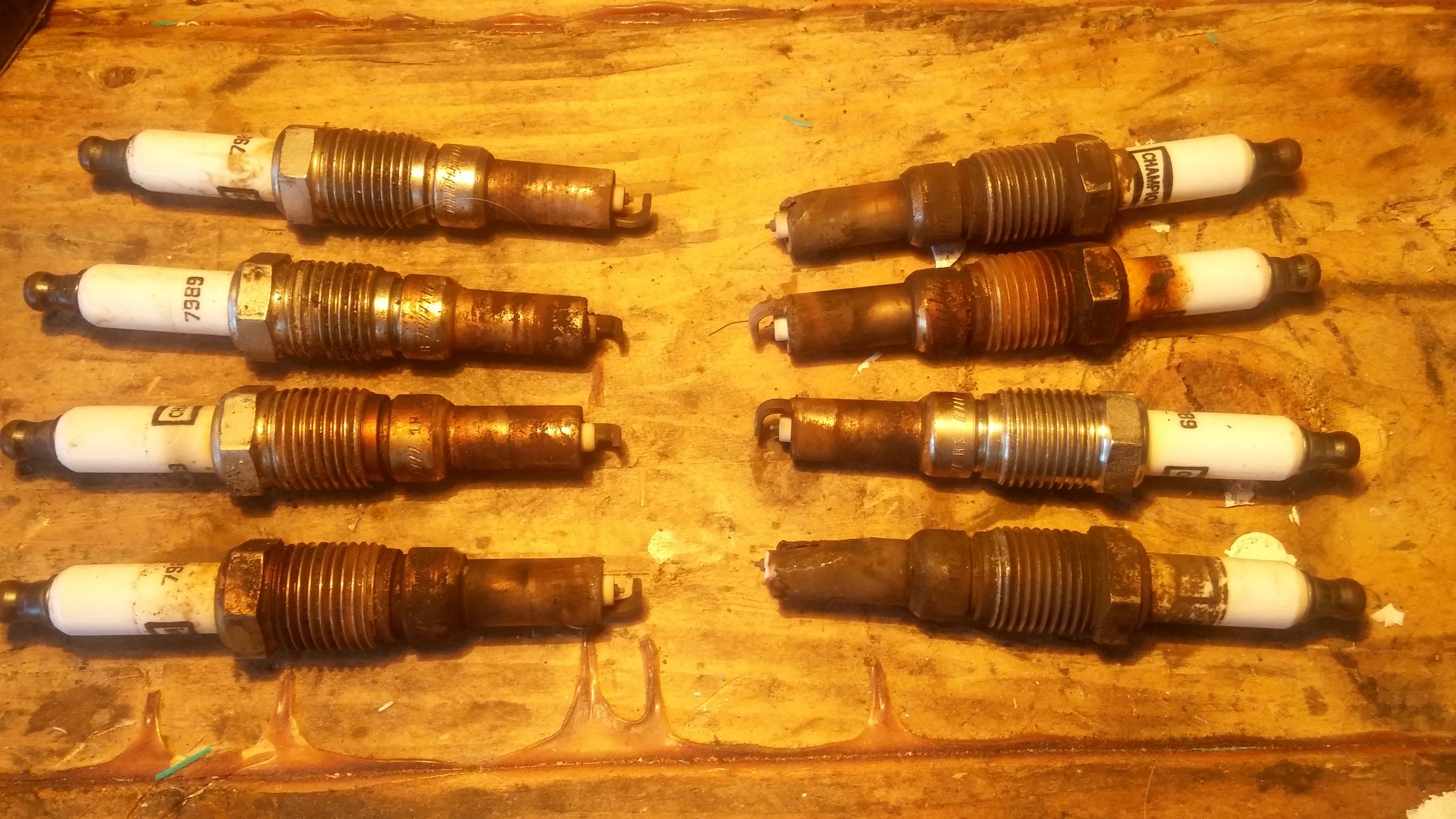

Thank you lakeland. That was a typo, I did get the 515 and have them installed. 2 hours to do the complete job, nice and slow and thorough. I did find that the #5 & #8 plugs were not even hand tight. So that is probably what caused the damage to the plugs themselves.
Just goes to show me again that if I want it done right, i have to do it myself.
But its done, running great. Better than it has since I took it to the shop of ill quality. I feel that I did the right thing by putting in the motorcraft plugs, and since they are the redesign, they will do great. What a pain in the butt it is working on that motor. I am 6'2" 230 and had to get up and sit under the hood to get 7&8 out. But its done, done right and I think I won't have to worry about it. Did my 5 mile test drive and no CEL, I think we are good.
