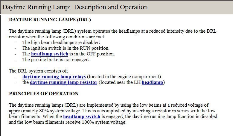

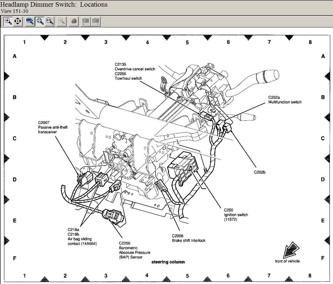

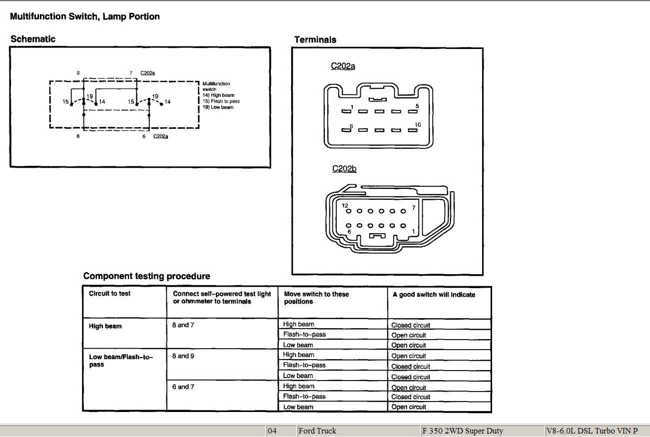

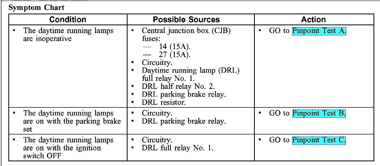

Go back to your original post you have new headlights with LED strips, What does that LED strips do do you think it's the DRL that's integrated into your new headlights? Or you are replacing your HL and DRL (a separate component)?
Do you have stock DRL on your F-350?
How do you know you are replacing or adding DRL? How do you know your new HL with integrated DRL are using the factory DRL existing wiring and relay?
If your truck doesn't have stock DRL you might have it prewired but no relay at the relay junction box, you have to buy and add.
There are still so many uncertainties and info you haven't provided and no pics from you whatsover, so I can only provide as much info as possible and you will need to troubleshoot that all by yourself.

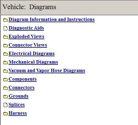

DRL below:
Diagrams-ALL index page above (to help navigate the huge pdf easier), the pdf below covers your whole truck, so as Locations-ALL below.
Your 04 doesn't have BCM module, so resetting with a scanner or disconnect the battery doesn't work.
Parking Lamps Below:

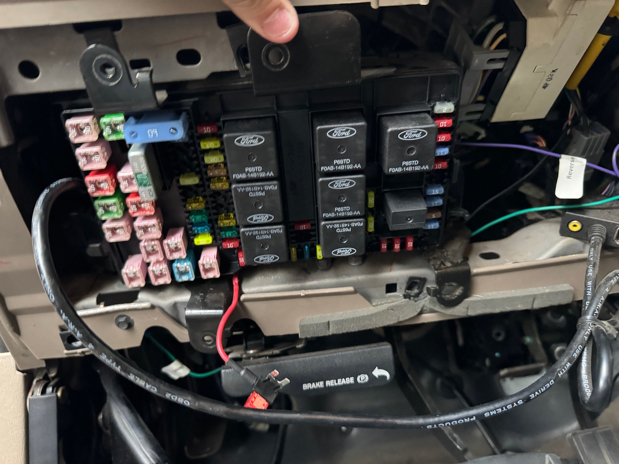

You very likely missed another fuse. Use a test light or voltmeter to check ALL the fuses, the ones in the engine compartment and under the dash.
Old May 25, 2025 | 10:22 PM
Bradschroeder05's Avatar
Joined: May 2025

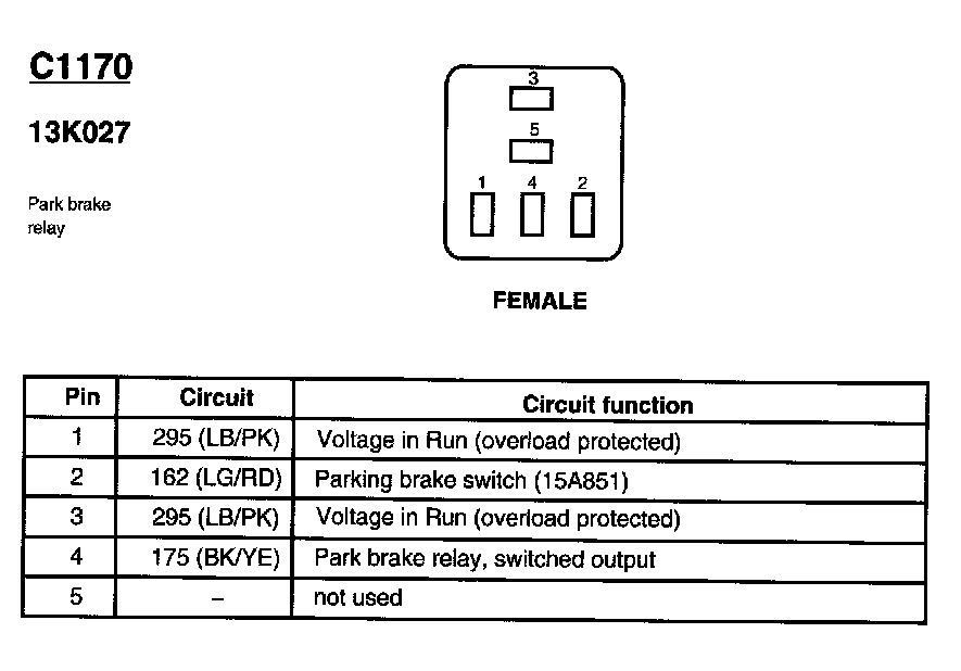

checked all fuses over with a light. all good. replaced all the relays seen here and the ones in the engine bay. i don’t know if i’m missing a relay somewhere. i attached a trailer today and all the lights worked on the trailer. i thought with it being a dually that the marker lights were apart of the trailer circuit.
