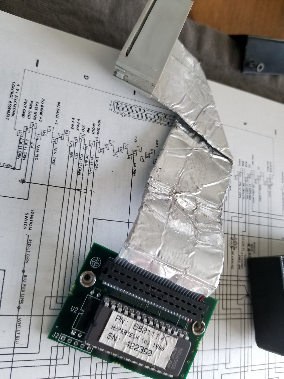

Hello y'all,
Im new here could use some help. I have a 88 f 250 5.8l 4x4. Chasing a issue with the ecm. A prior owner installed a hypertechoff the back of the ecm. There is a short in the harness on the hypertech. So if you slightly touch the harness it kills the power to the fuel pump. I called hypertech and they said to remove it and it will be good. Well when i remove the chip i get no power to the fuel pump, so i figured it needed a ecm ordered the correct one and installed it and same problem. So i pulled it back out put the old one back in with the hypertech
and taped the harness down and it runs. But i really want it fixed correctly. Any help would be great

thanks for the reply. Ive triple checked the harness, it has something to do with the hypertech connection to the ecm. Ive narrowed it down to that silver ribbon harness in the pic. But the damn thing will not work with out it.
