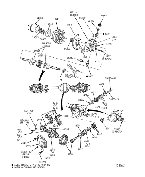

I did not read through the thread. I apologize that I have been a little less available everyone, I am in the process of training a new employee and it has been extremely busy. I hope that the diagrams I have attached help you out.
Attached Thumbnails F-350 Front End-diagram1.png   F-350 Front End-diagram.png   F-350 Front End-diagram2.png   F-350 Front End-diagram3.png   F-350 Front End-diagram5.png
