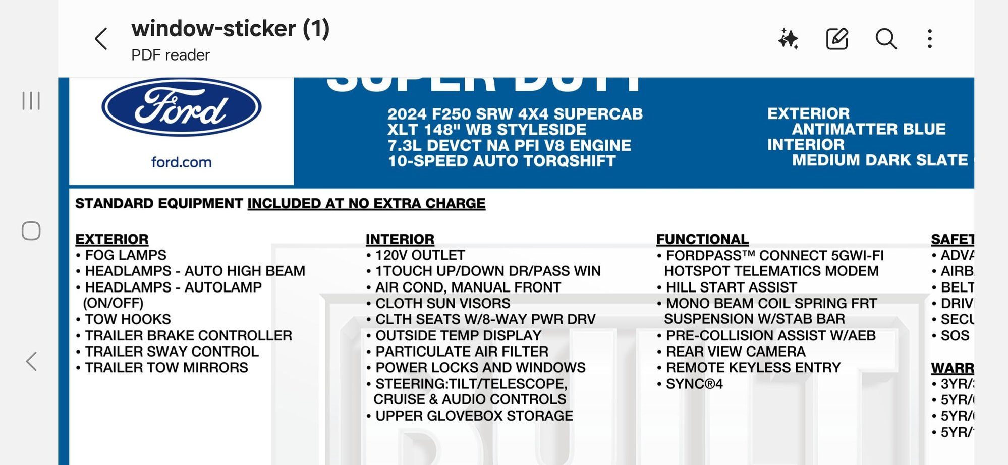

So I'm doing research to possibly buy a new F250. Looking at the window stickers, I see some that come with dual batteries and some that don't. Why would it come with dual batteries? What is the purpose?

7.3 Gas.
