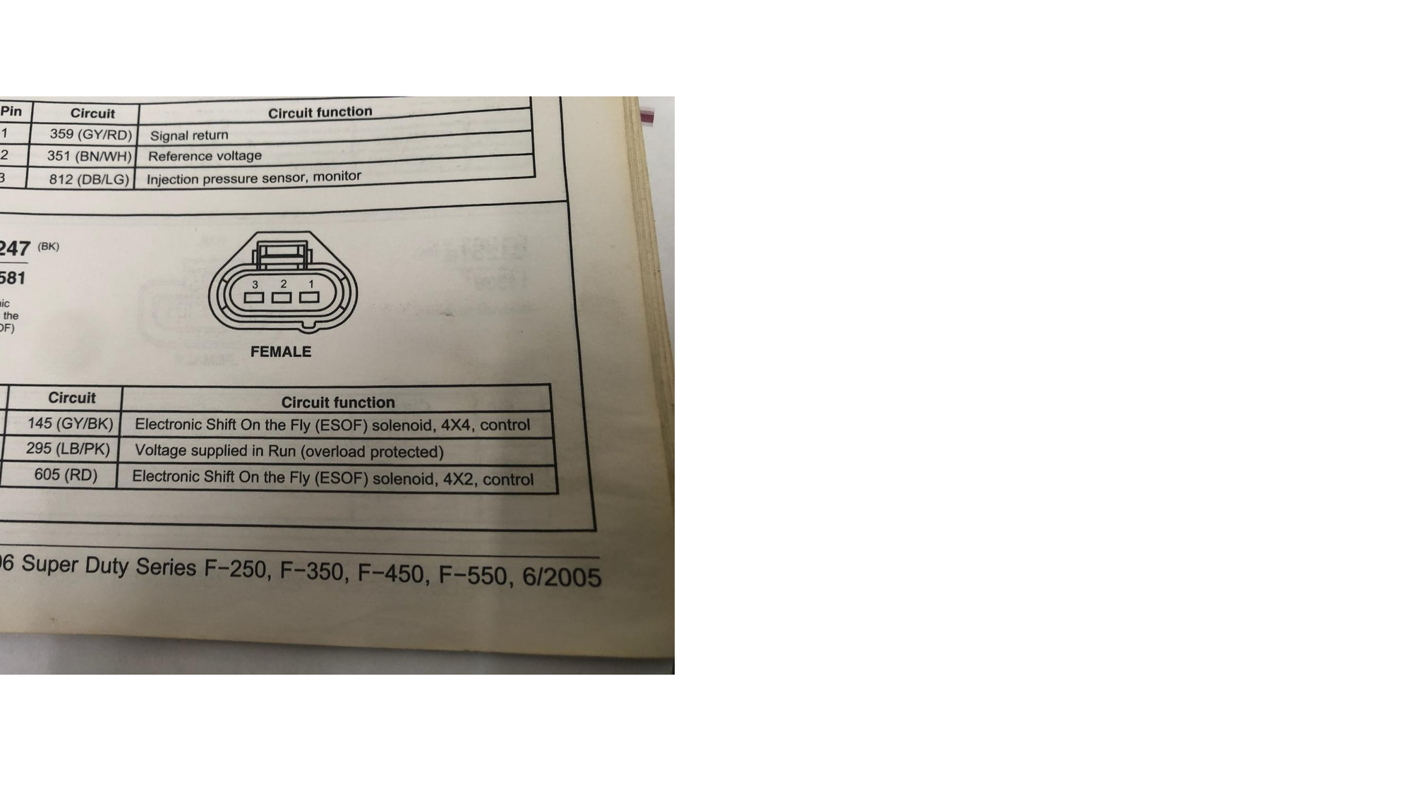

The connector comes apart and you can remove the pin from the damaged wire and "re-pin" it - if you get the right tool to remove the pin.
https://parts.ford.com/content/dam/f...il%20Final.pdf
Also, it looks like to me that connector WPT-170 (1U2Z-14S411-AFA) might fit AND maybe also WPT-993, Tin greased, also listed as WPT-1U2Z-14S411-AFB).
https://www.fordpartsgiant.com/parts...4s411-afa.html
Or maybe WPT-754 (3U2Z-14S411-EYAA) - but the ones above looks more likely to me.
The connector is # C1247. I'll post a pic of it in a bit.
Just trying to give you options.

I did some more searching in the catalog and found this:
WPT 993, 1U2Z-14S411-AFB (page 19)
• Module - Transfer Case Shift Control
• Sensor - Acceleration Pedal Position
• Sensor - Throttle Position
• Solenoid - Pulse Vacuum
I bet it is this one.
https://www.fordpartsgiant.com/parts/ford-wire-asy_wpt-993.html
https://www.oreillyauto.com/detail/c/motorcraft/lighting---electrical/connectors---terminals/throttle-position-sensor-connector/faa1fd5cbb34/motorcraft-multi-purpose-connector/mot0/wpt993
