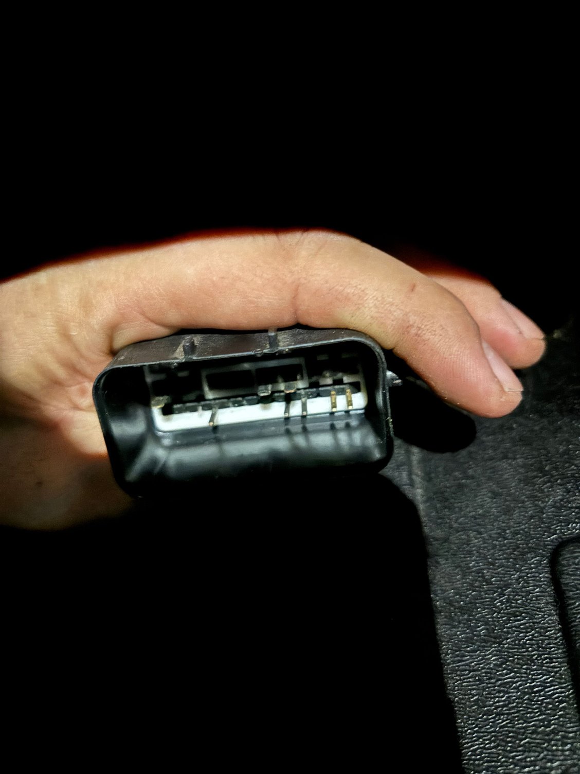

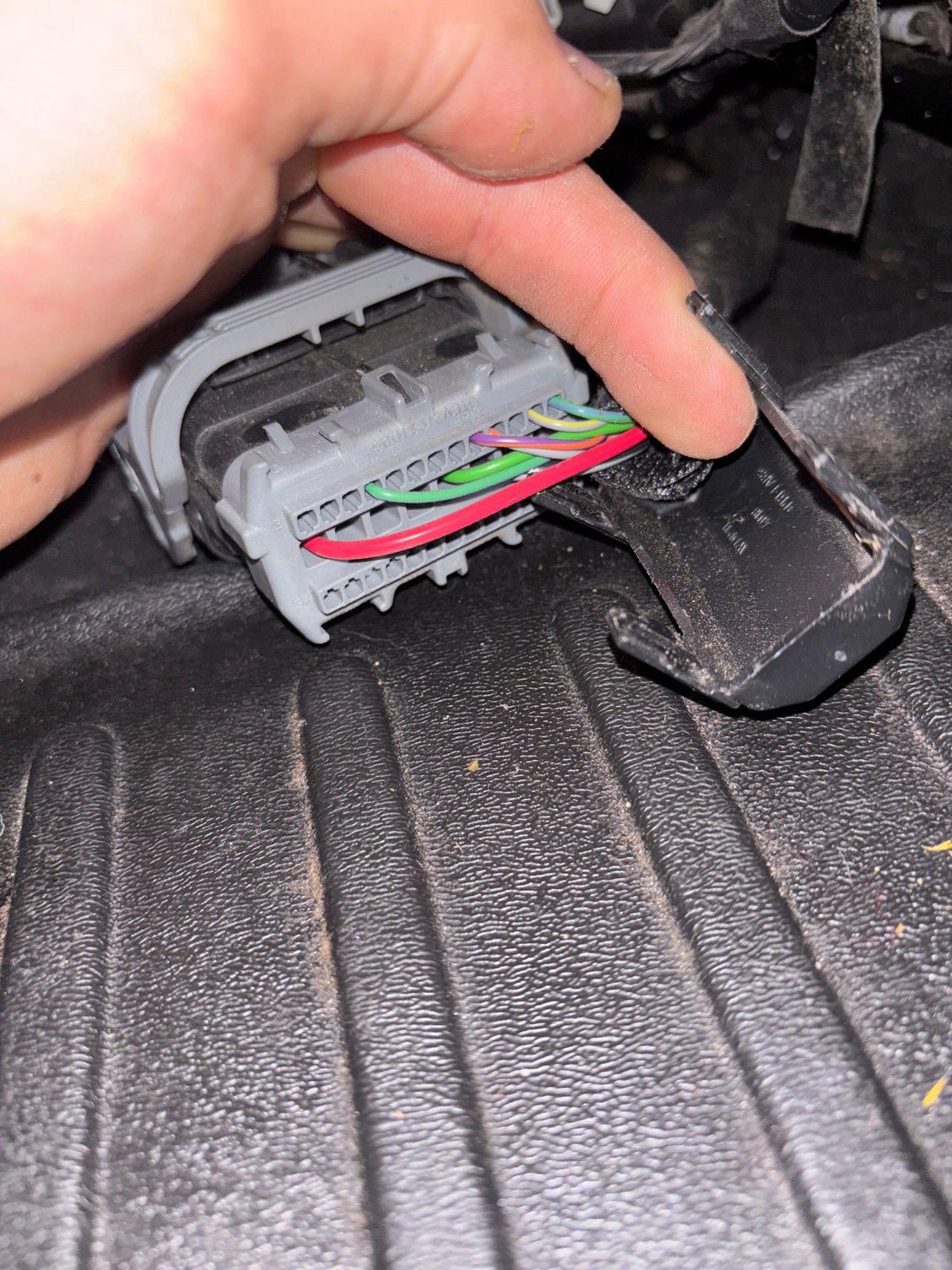

Can anyone tell me if I can add power seats to my truck?? Can’t find anything on saying I have power seat plugs I found out what pins I have which are 1,2,4,5,10,16,17,21 same on passenger side. The connections on the seat part only have like 3 wires coming out of it and was wondering if I can buy some power seats and just plug and play for them to work

I read your other post so you have 2020 F250 6.7L
My alldata only up to 2008. I looked thru it a little bit and I think you can get power and heated seat to work, just not the memory seat.
For memory seat you need to program the DSM (driver seat module), in addition, you might need to replace your ECU before you program your DSM. If your ECU is compatible then you still need to code it (to activate it) when it's deactivated at the factory. 2008-up uses can bus communication, that can create another problem.
On the power, not sure what plug you have, based on 2008 F250 5.4L there should be 4 plugs but you can always hardwire to the switch to make it work.
On the climate control seat, forget cold just use heated function, you will need to run a relay, you still can hardwire it to make it work, just need an external switch other than the factory one.
So don't expect anything to be plug n' play, it's a retrofit.
Another issue is when you buy a pair of used seats you never know if the DSM is working or not, or it's removed and sold separately to you, same for the heated element on the seat which might not be working.
