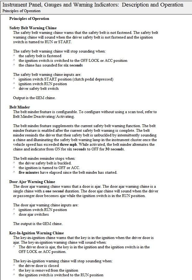

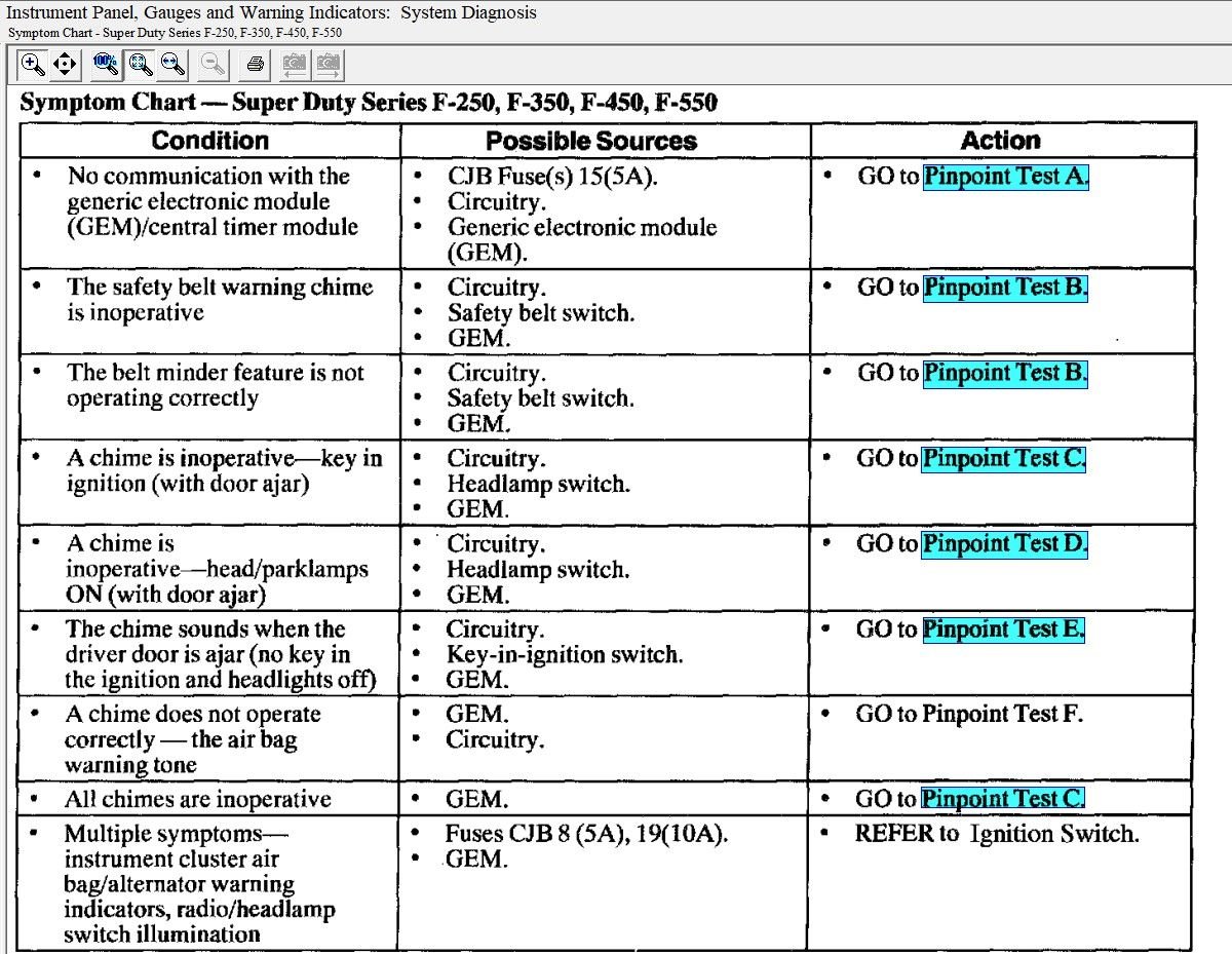

Check above you can't locate glow plug when it's not part of warning devices.
Pinpoint E pdf attached below. Just E.
Refer to key-in-ignition step 2 below, insert an allen wrench, pick the biggest diameter but slightly smaller than the access hole. Do NOT use any punch, pick or any screw drivers, use allen wrench only, if you don't have any, you can use T30 torx screwdriver (no T20, still too sharp head)

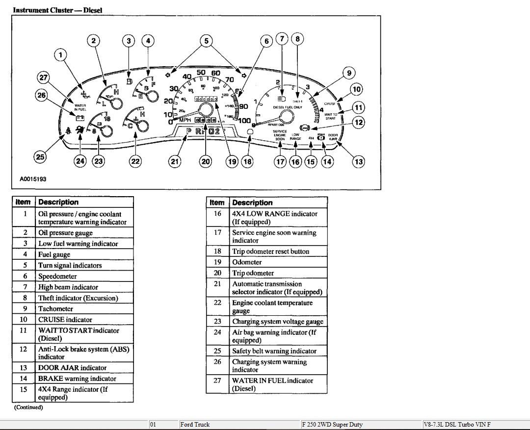

Does it have a "Wait" light on the instrument panel that needs to go out before you can start the engine?
If so, there is a Glow Plug Module.and a Glow Plug relay located at the top rear of the engine.The only way you can verify the glow plugs are working is to check for power at any glow plug when you first turn the key on and the engine is cold.The relay supplies the power. You should have 12 volts there. Do you have the 12 volts there ?

I can answer 2 of the 3 questions. The engine is a 7.3 Diesel. It does not have a "wait" light on the instrument panel. The part about checking for 12 volts is above my knowledge about how to do that.

Are you sure you're not hearing the SRS/RCM (Restraints Control Module ) beeping out a DTC/code? Generally the beep tones are counted and the long beep (long is a separator code) on the start events.
Old Jan 29, 2026 | 05:45 PM
Posts: 1,283
Originally Posted by Huntersprings
It still beeps when the door is opened

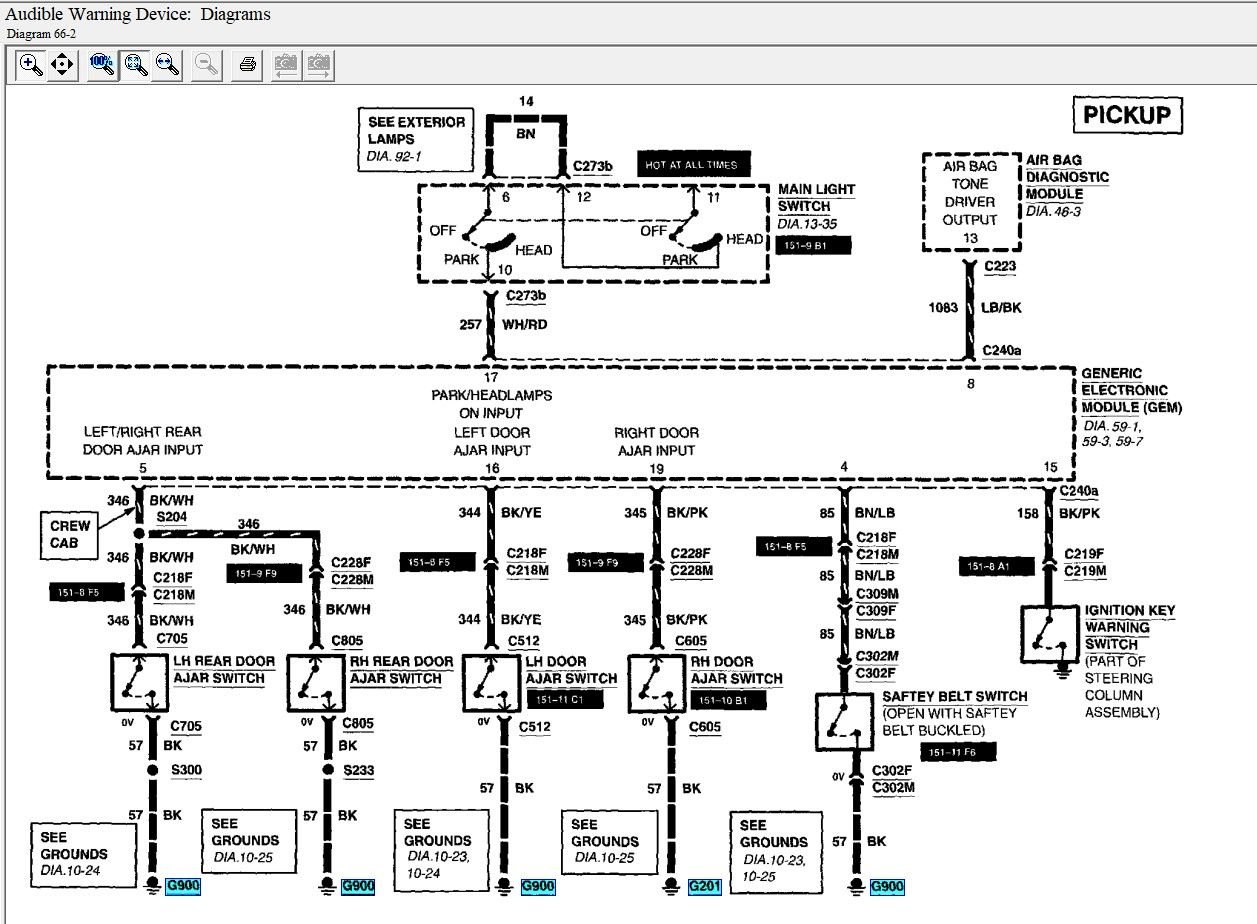

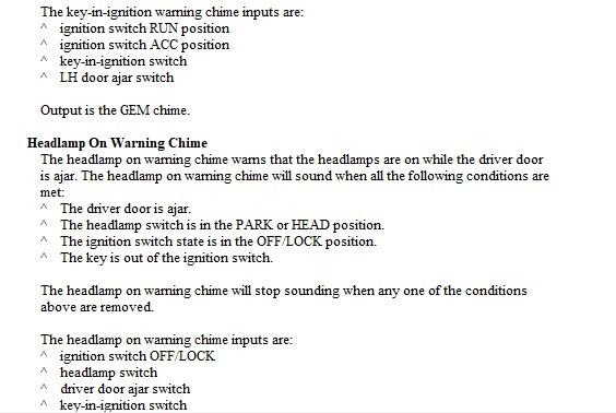

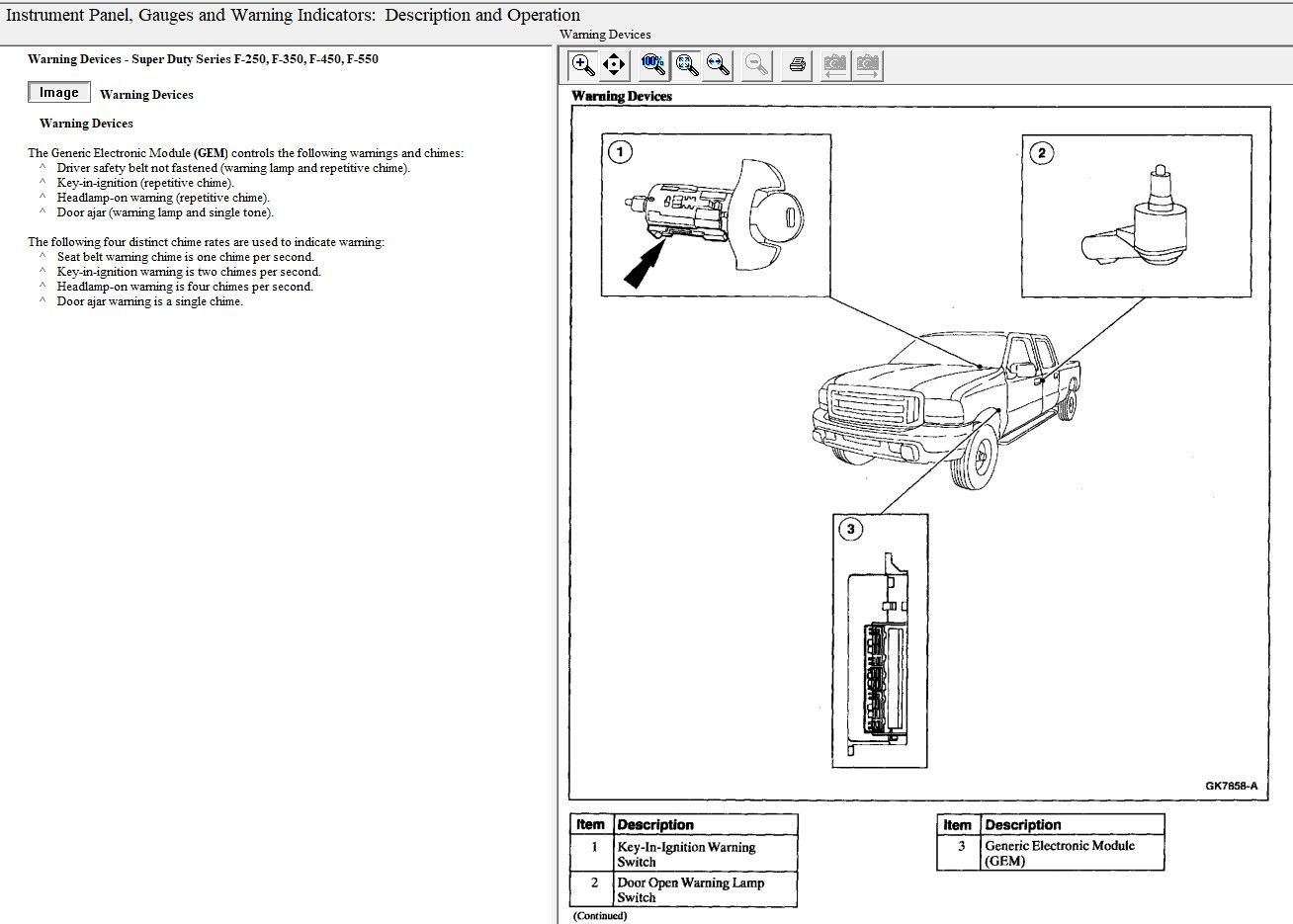

Assuming the key is out, simply based on this scenario, it is more than likely to be the key-in-ignition when its pins are still touching something and getting ground signal, this is a mechanical issue you might need to lubricate or bend the pins to get it fixed.
For the others like belt minder, headlamp on and door ajar, you should also see the associated LED illuminated on the cluster, if not it can be a sticky ignition lock cylinder (simply use "dry lube" to lubricate it on the bench) but then you would also get parasitic draw despite key out and the associated led is not illuminated on the cluster. To verify this use a scanner able to retrieve ford's specific DTCs you might see GEM or other modules that can't go into sleep mode when they are supposed to.
Whether or not the glow plugs are having issues, and doesn't matter how many beeps you are getting, troubleshoot this one at a time, check the key-in-ignition first, when It still beeps when the door is opened.

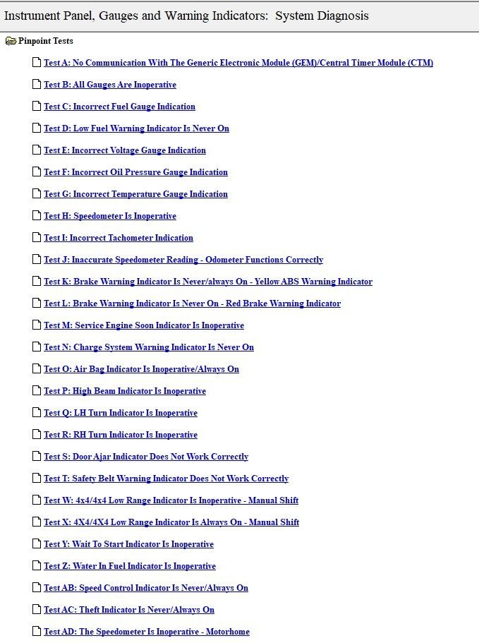

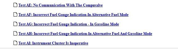

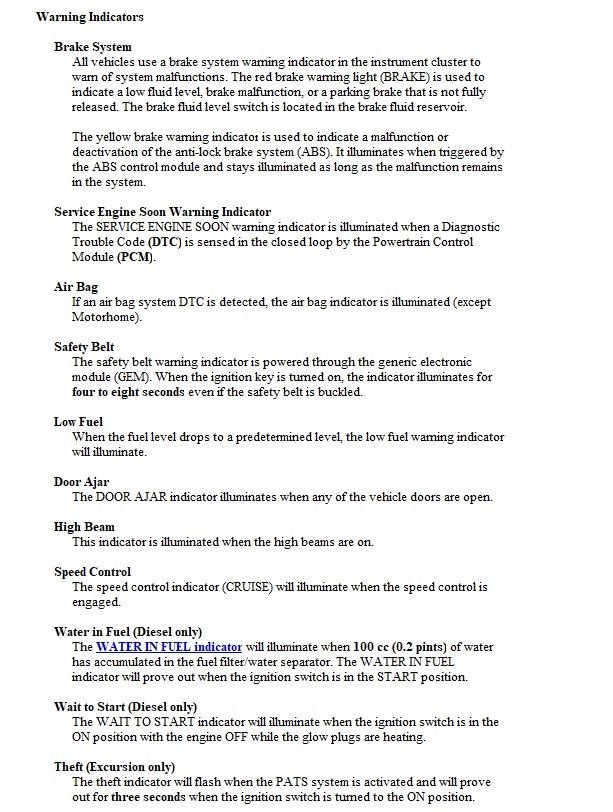

What you should also do is to ensure your instrument cluster is fully functioning.
Pinpoint Test index page shown below. Check Pinpoint-All.pdf below if needed. At least verify any device that generates the beep, and ensure the associated LED proves out (illuminates when key in ON/RUN position, and turns OFF in a few seconds or when key in START position) correctly. If your door ajar LED bulb burnt out, you might have a bad ajar switch generating the beeps but you can't tell visually on the cluster, if that's the case check Pinpoint-S below.
