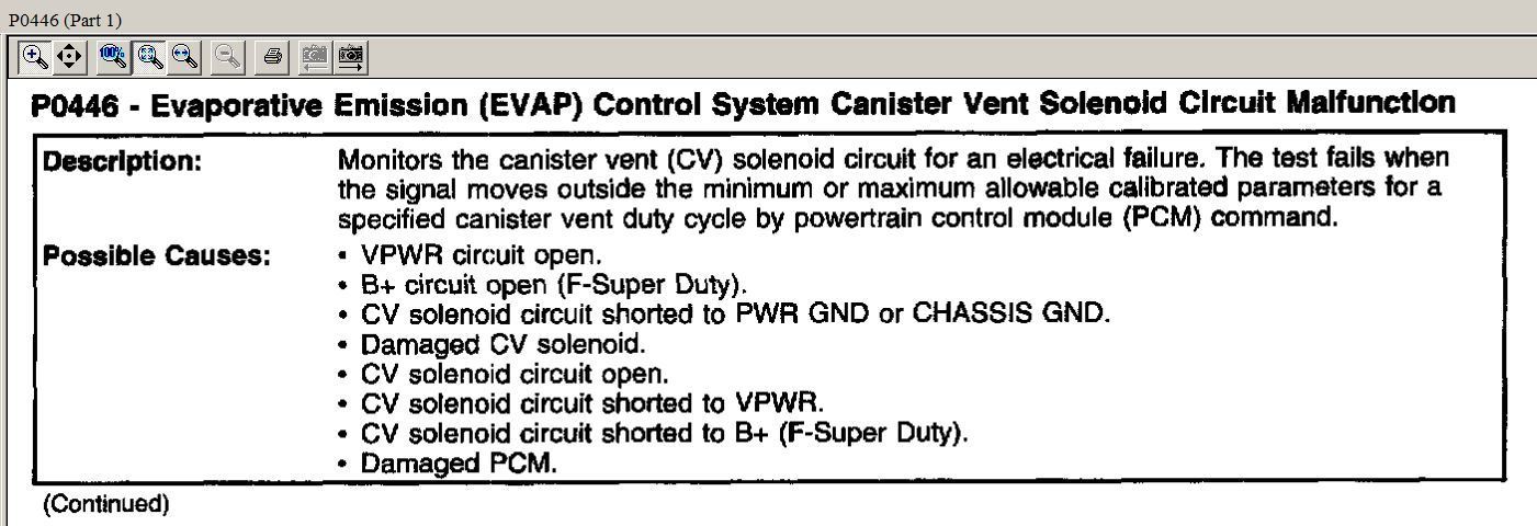

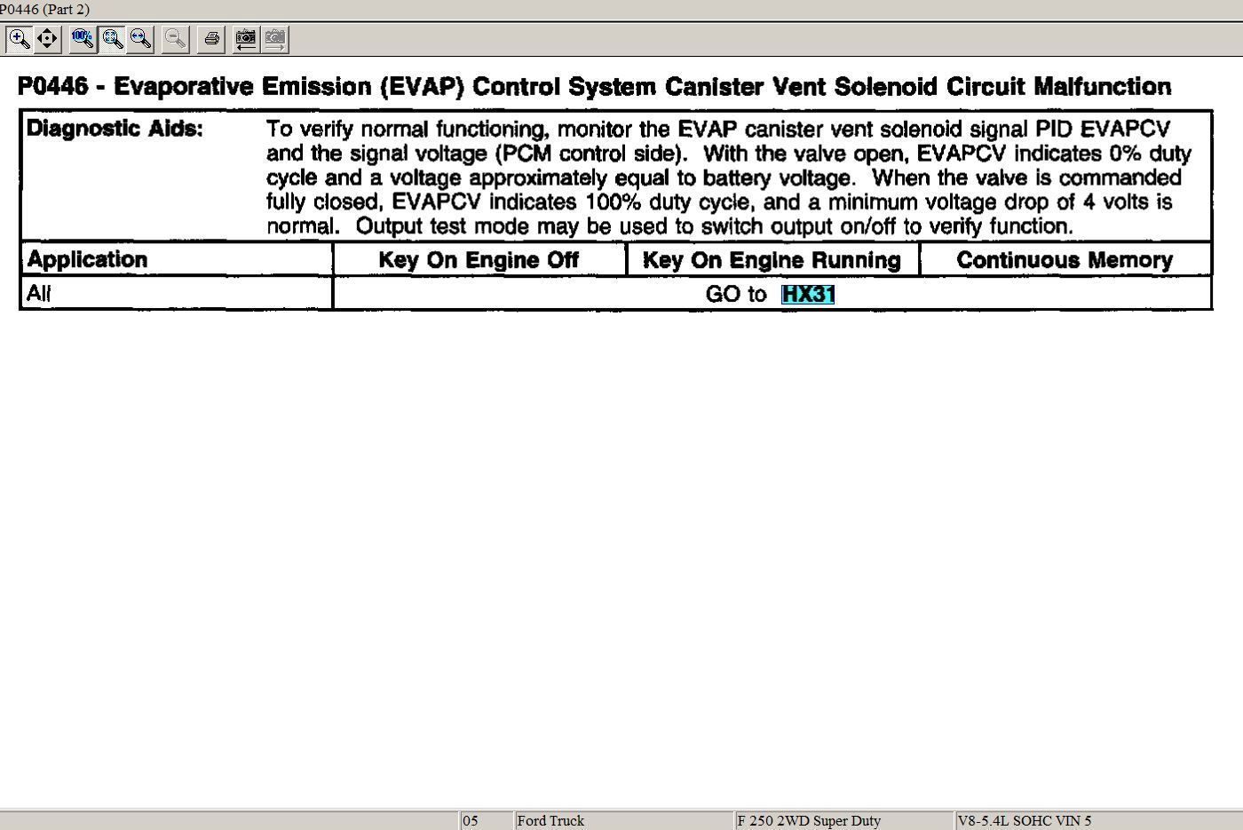

Posts: 1,279
Per my signature that's what you should have provided before you ask a question, I thought you saw that from your previous thread.
2 Relevant PDFs below.
