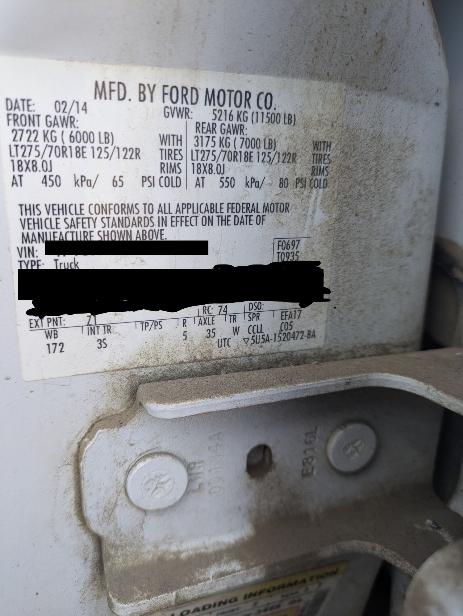

If you can provide 2 things.
Year of your vehicle and trans code on the door sticker.
With that info should be able to help.

Thanks for the responses! It is a 2014 F350.
