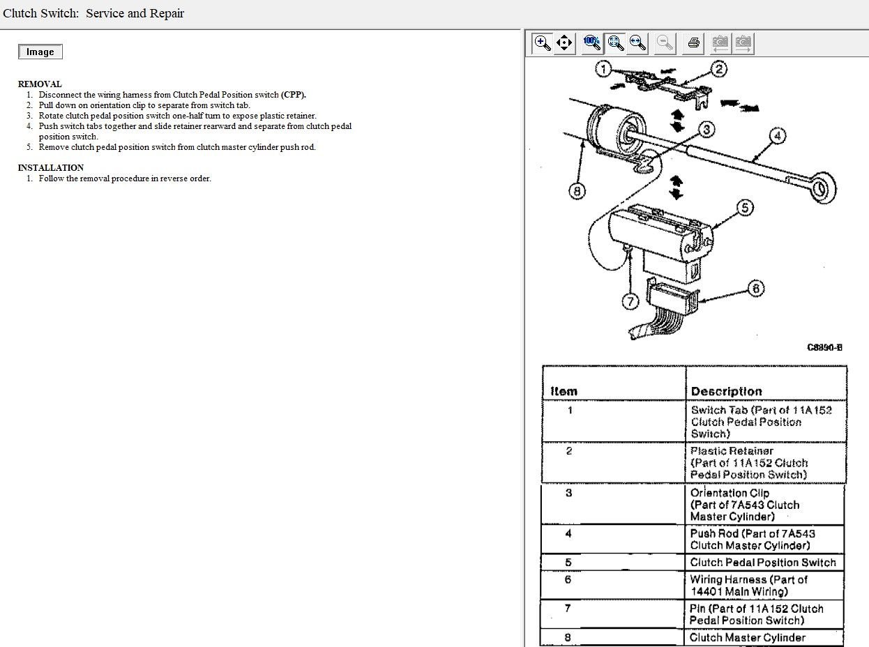

Look under the dash and look for the link the clutch pedal pushes to operate the clutch safety sw and clutch master cyl..
The stub on the pedal arm connects to an eyelet that when the pedal is depressed activates the sw assy and master cyl.
Look for excessive wear on that eyelet, which can be temporarily repaired or the rod replaced.
Not knowing what facilities or tools you have ,it might be simpler to just replace the rod.
There are a few videos on U tube showing this.
Let us know what you decide to do,thanks..

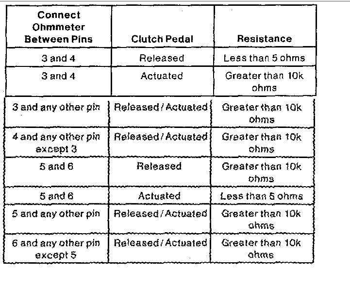

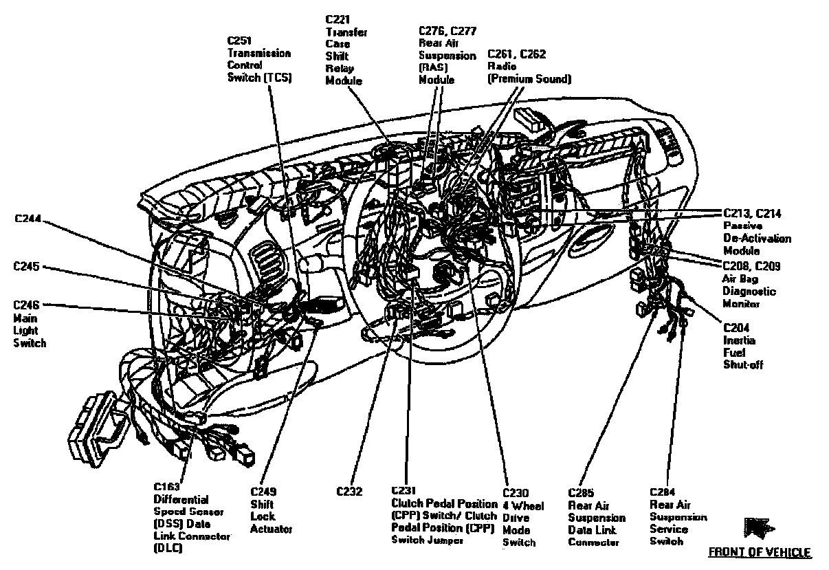

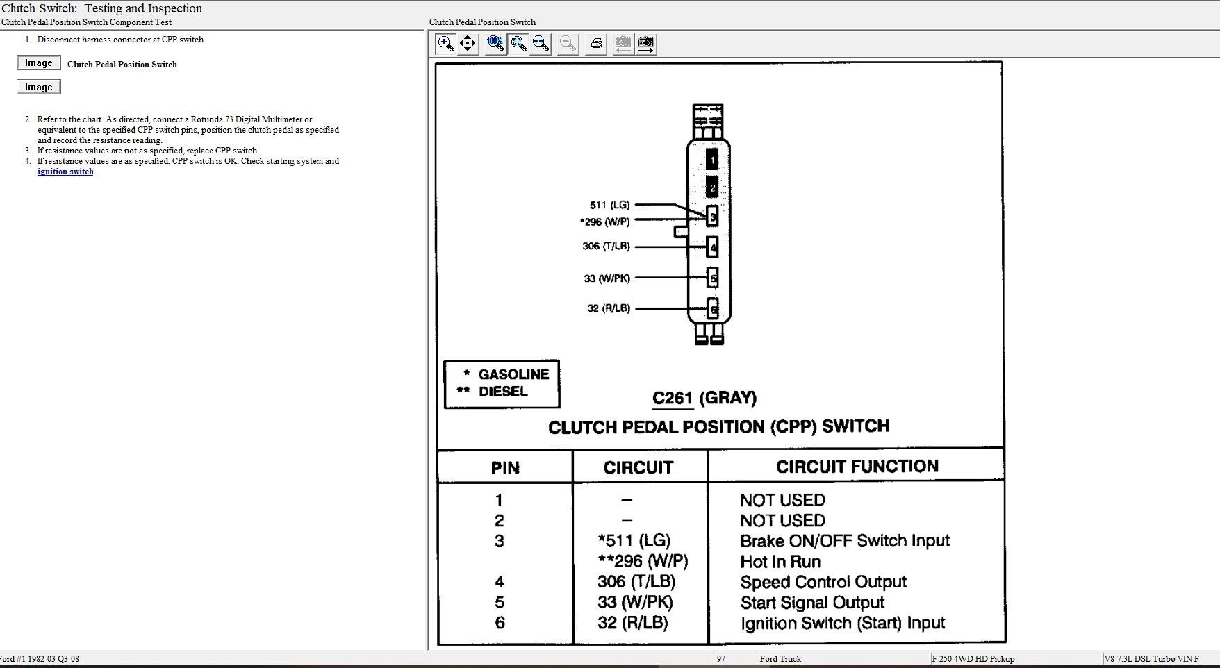

For no crank no start you would need the long jumper wire to test the starter solenoid but since it's crank no start and on M/T with CPP (clutch pedal position switch) on yours and most other cars with clutch interlock switch please check the following accordingly.
