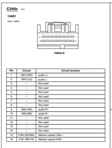

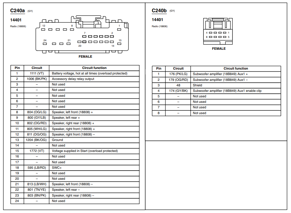

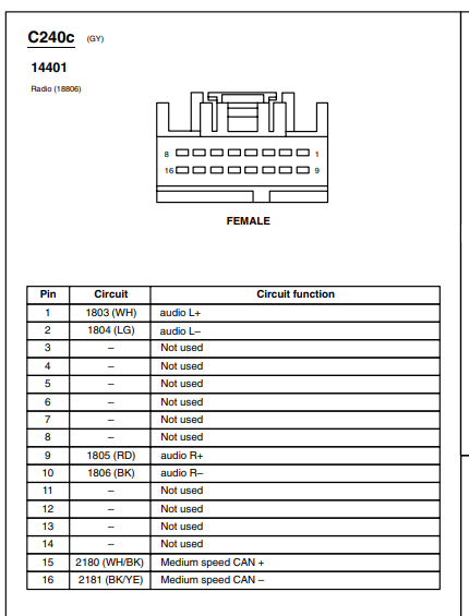

I think these would be three three radio plugs you mention. You will not be able to access the source I have.
