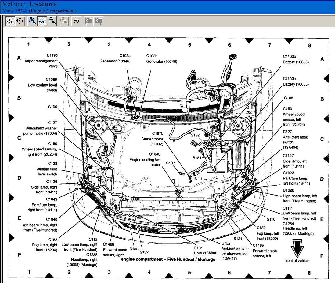

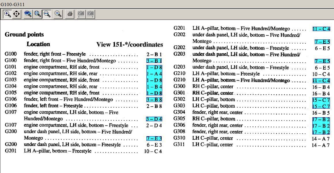

Chasing a possible grounding problem in my 2005 500..In my previous posting with slow starting and rough idle issues when cold, I replaced 165K starter with a new unit. Installed it and still turned over slower than it should. It did start but ran poorly for the first few minutes then smoothed out and was ok..Advice here was too use jumper cable from battery ground to starter housing and try starting when cold. Did that and it started right up and ran perfectly. So I’m guessing a ground issue from battery to engine block.
On the wiring diagram I see a G107 ground location down there somewhere near the starter. . Does anyone know specifically where it is. I really don’t want to remove the starter in a search saga if someone knows where the G107 location is.

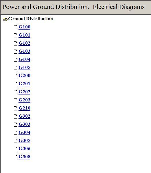

Ground Distribution (Electrical) index page shown above.
Ground Point (Location) index page shown below.
G107 check 151-3 above, or below here:

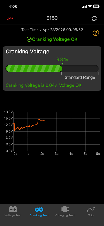

Posts: 1,263
On a 2027 brand new car and the battery is fully charged, a normal cranking voltage should be 9.6V to 11V.
On an old car with new starter and new battery that cranking voltage range shouldn't change much. As you can tell the age of the cables matter a little, but it's how much current draw (could be 200+ amp) it takes to start a car.
I already mentioned a dozen times, must buy the battery monitor, problem solved as far as starting is concern.
Old Apr 28, 2026 | 04:16 PM
Posts: 16,640
How does the battery monitor or the charging system know when to lower the charging rate?
Resistance gets into the picture. If there is resistance where the monitor connects to the battery the charge rate dro0ps down to 1 or 2 amps so it doesn't cook the battery and if there is corrosion offering resistance because it thinks the battery is fully charged, guess what !
Old Apr 28, 2026 | 06:29 PM
Posts: 1,263
I've got a cranking voltage of 9.84V this morning. If I recall my last 100 cranks are as follows:
10 between 9.0V to 9.3V
10 between 9.31V to 9.6V
60 between 9.61 to 9.99V
20 between 10V to 10.5V
9.6V is the minimum healthy cranking voltage, which would show green on the battery monitor, any voltage under 9.6V would show in red color.
So 80% of the time my cranking voltages are above 9.6V which is considered healthy of course on my 98 E150 4.2L.
Imagine if I consistently getting red color (below 9.6V) 50/100 of the times, that is a good sign of a problem to the starting system, which includes battery, starter and its wiring.
saemetric specifically stated that he got a new battery and new starter, so it can be bad battery cables, of course assuming his new battery is in good condition, and not a low SoC (below 50%), if he gets 9.6V or below cranking voltage 5/10 times then it's a good indication of the bad cables.
The battery monitor is a must buy for anyone who drives, I mentioned this a dozen times. It shows more than just the current voltage, the SoC percentage (with history view), and the cranking voltage, and charging test too if you look at the pic shown above.
