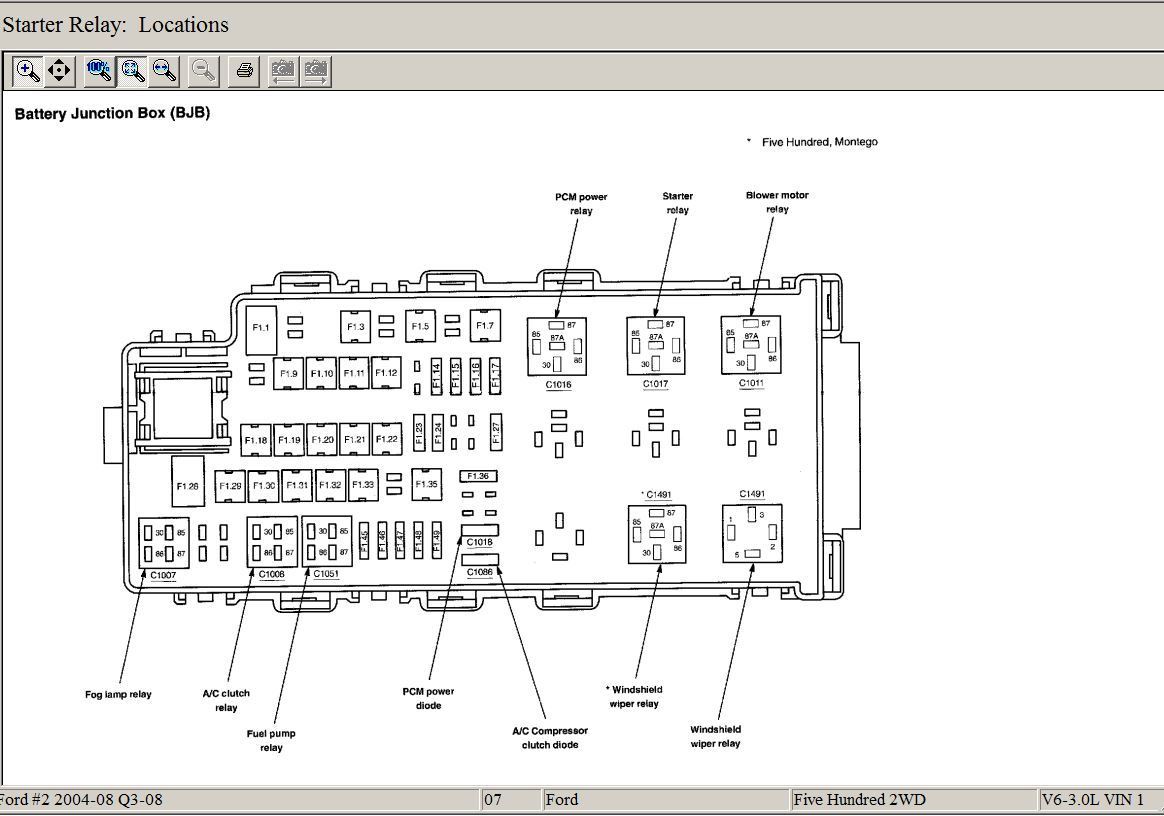

Borrow the wiper relay (C1491).
If it doesn't work with the key still, check below:
1) Check the F10 (30A) fuse see if it's good, then unplug the starter relay, voltmeter red to terminal 1 of starter relay, voltmeter black to battery negative post, then turn key to START position, you should expect battery voltage
2) Unplug the starter relay, key in ON position, ohmmeter set the dial to 200Ω, red to terminal 2 of starter relay (circuit 32, Red/Light Blue wire), black to battery negative post, you should get non-zero 5ohm or less.
3) If not, it could be a problem with your PATS causing your PCM not sending ground signal thru terminal 2 thru circuit 32 to terminal 2 of your starter relay.

Old Dec 15, 2025 | 06:26 PM
It's not the PATS when you already tried two different methods:
1) battery directly to the starter solenoid
2) key switch directly to the starter relay
And when you can start it at the starter relay, refer to the previous diagram check circuit 1785 do you get battery voltage when key in START position? Do you get ground signal at circuit 32? <- (this is important and there is a workaround, you can simply ground this circuit) Circuit 1786 do you get voltage with hot at all time? You don't need to check circuit 33 because you can start it at the starter relay previously.
The cooling fan running non-stop is another issue it can happen if you have a bad relay. Check pinpoint KF below.
If you need to reset adaptation on your TCM, I assume you already programmed it when you replaced it, check foxwell NT510 Elite w/ Ford on Amazon, keep it if you like it.
