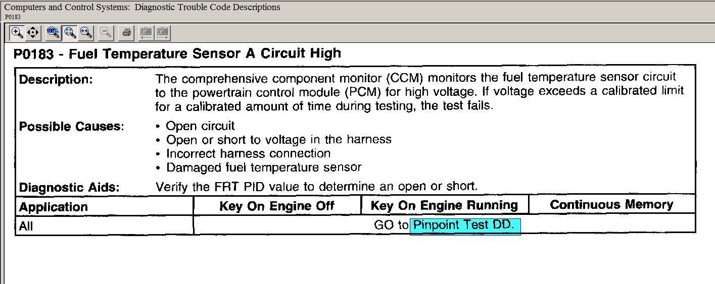

Exactly where it is, I can't locate the diagram but per Pinpoint DD pdf attached below, it's on the fuel rail and the connector has 2-pin and named FRT. Do not remove the sensor, just disconnect the electrical connector and clean.

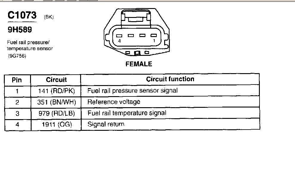

More than likely the root cause is probably not the sensor itself if it was replaced a few years ago, it should be the wiring or poor connection, the 2 wires that just need a bit cleaning or even a problem with the fuel pump causing high pressure throughout the fuel rail, so don't just check temperature, you check the pressure as well, checkout FRPT below. Pinpoint DD.pdf attached previously covers a lot of troubleshooting procedures and details.

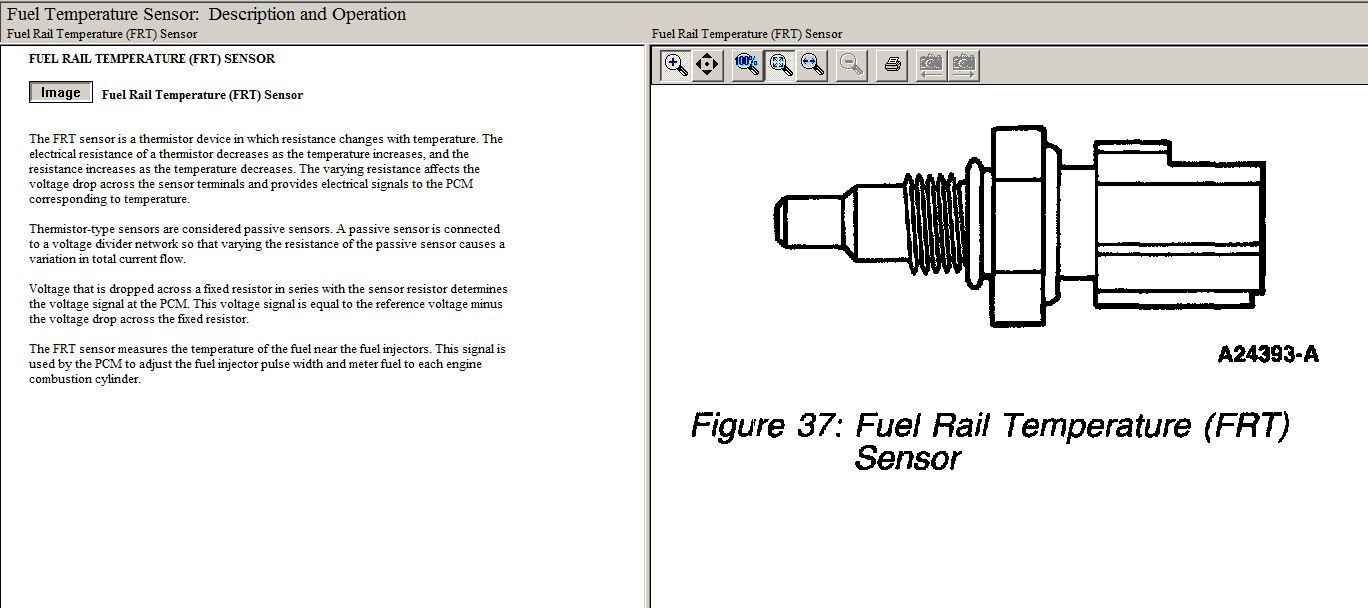

If it was an issue with ECT sensor then you have to fix or replace immediately. On FRT sensor, perhaps just poor fuel economy that doesn't require immediate attention.
If the wiring and connector look okay then you should look into replacing the sensor, just FRT and not FRPT, you will look into it this Sunday so that's good.

If you look at P0183 diagram above again, there are 4 possible causes. The first 3 is related to wiring, the CEL would stay on or turned back on in a few minutes after reset if that was the case, but you said CEL was off for a couple of days, then it's not the wiring issue, so the 4th possible cause, the sensor itself.
