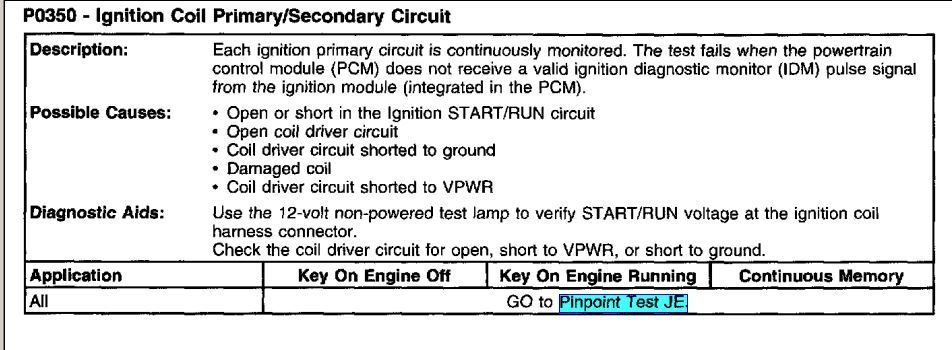

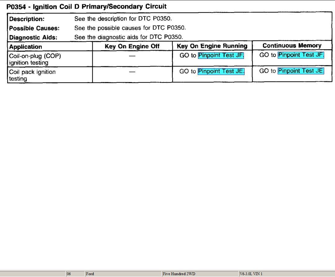

1) Check Pinpoint-JF first. When asked to check on Pinpoint-JB or Pinpoint-Z then download them.
2) Check Pinpoint-JE. Check Reference_Values.pdf when asked.
