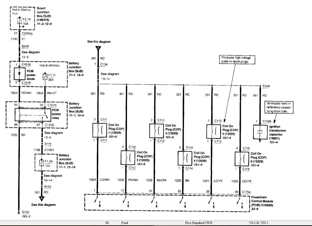

Thank you so much! I will definitely check that out. Not much else to go by and I appreciate that diagram as well, I just wish I was smart enough to understand those schematics. Working all weekend so I won’t even have a chance to look at it till maybe Monday. So far today, the car is working great. I think my car is psycho and has two personalities.

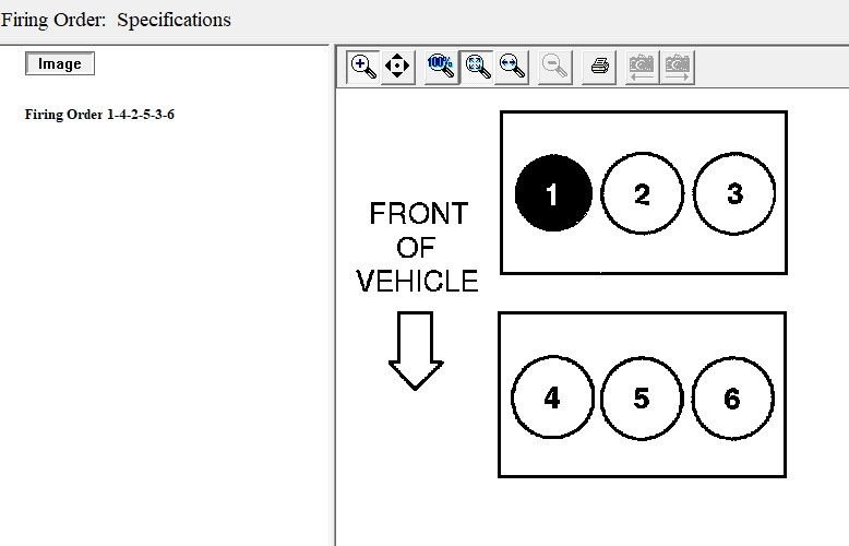

If you are looking at the engine from the front of the engine where the crankshaft pulley is located, the cyls on THE LEFT SIDE are numbered 1,2,3 from front to rear. You are looking at that #4 cyl, right ?

Hmmm…. When I use my code reader it always says coil D, which I thought was the coil that is closest to the firewall on the passenger side. Is this correct or have I been looking at the wrong coil?
Old Apr 1, 2025 | 07:48 PM
  #17
Your P0354 already specified # 4. If it was # 3 you would get P0353 instead.

A picture is worth many words and the #4 cyl is shown in the pix.

Keep in mind the "circuit" includes the plug, coil, wiring, and PCM..
Any one of these with a poor connection or intermittent fault are capable of causing this code..
The idea is to check and verify all of these are are doing their job all the time.
You could even have a poor connection at the PCM where the multiple connector plug connects to the PCM. All these need to be checked for cleanliness and tightness to assure a good and constant connection..
