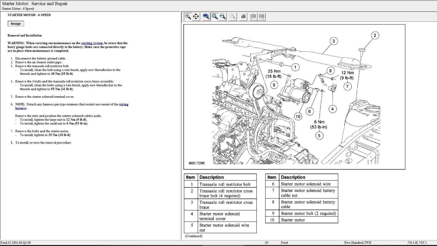

Just bought a 2005 with 91,000 miles.
Starter grinds on flywheel sometimes.
Shop found three missing teeth on ring gear.
Installed used flywheel. Could not locate new part.
One week later, Starter grinded again.
Any known issues with the 3.0/6spees automatic ?
Any different starters from a related application?
Thank you

Old Nov 4, 2025 | 04:49 PM
A little info if you will,,,,
You say the flywheel was replaced, what about the starter ?
There is a drive (Bendix drive assy) in the starter that gets moved out to engage the flywheel when the starter solenoid is energized. If the solenoid is faulty and cannot get the drive quickly engaged with the flywheel you will get the mashing /grinding of teeth. Was the starter replaced at anytime ?
The more info you can provide the better a diagnosis can be offered.
Yes, new starter. and battery
thanks
Been a week trouble free.
It was a $2200 car. Not worth more money.
Still curious why it would grind again.
Ring gear has all teeth, new starter and batt.
(original flywheel wasissing three teeth.)
thanks
Old Nov 7, 2025 | 02:34 PM
Why do I have that feeling we are not done with this problem yet ? What ever was moved in the process of replacing things may have corrected the problem, lets hope so.
