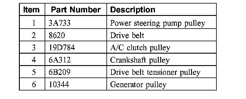

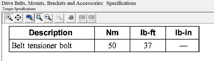

The belt should last 60k to 100k if you think it's causing problem try to set your torque wrench to 37 ft-lb and tighten the tensioner bolt and see if it was under-torqued.
If you decide to replace # 2 and # 5 shown above, get this belt: Gates K060840HD the green belt if available for your car and this belt tensioner assembly:
Motorcraft BT81 Motorcraft BT81
and don't buy Motorcraft JK6844C belt. The HD green belt from Gates is the best possible belt you can get for your car if Gates make this green belt.
