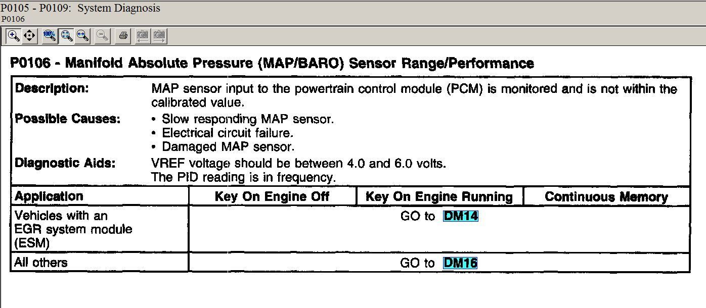

Did get a code today. PO106 during the warmup phase of the saga…It’s a MAP sensor problem. Where is it on the 3.0 V-6 five hundred engine.Or do I even have an MAP sensor. If,so, could this affect the problem I’ve been having.?

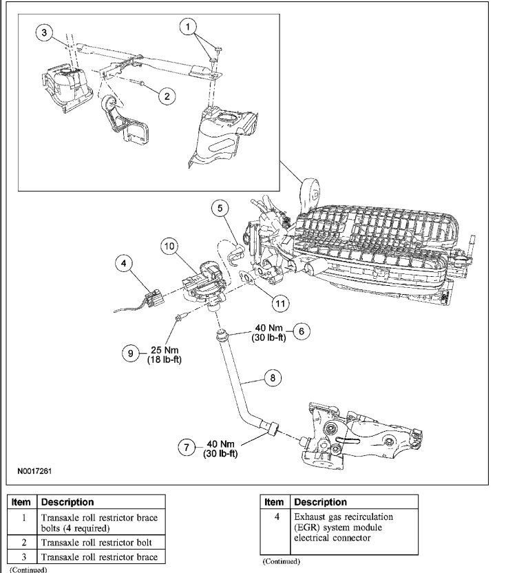

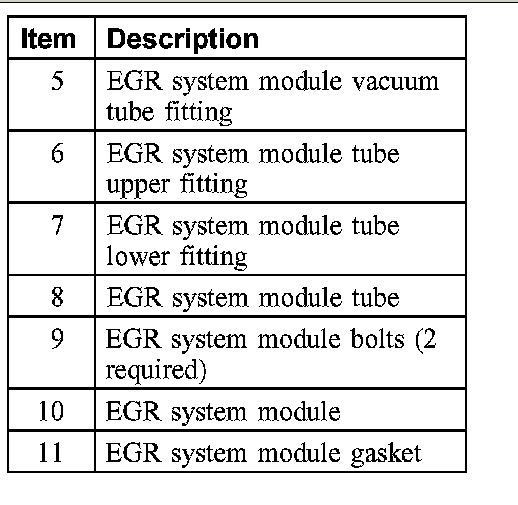

So check and see if you have EGR System Module (ESM) or not, you probably do.
Number 10 on the diagram above. Zoom out views below near throttle body and the firewall, could be difficult to get to.
Your MAP is integrated into the ESM and it might be possible to disassemble the ESM apart and clean the individual components at your own risk. ESM with so many different components integrated into it, is probably very costly to replace, perhaps $500 to $1000 and since it's a module you more than likely need to program it. Laptop w/ Windows + Forscan + Vlinker FS required if you want to DIY it. Vlinker FS has 18V FEPS support required if your vehicle is 2007+ but since yours is 2005 you don't have to buy Vlinker FS but then it's inexpensive so just buy this adapter if you want to program ESM or any other modules in the future if you own a 2007+ car.
Of course download and follow the Pinpoint-DM.pdf first.
Don't forget to buy the battery monitor and OBDLink MX+ first I guarantee you won't regret. The P0106 not sure what scanner you using, you need MX+ to retrieve all the Ford's specific DTCs, all the non-P0xxx, and non-P. The pinpoint-DM test mentions that you need to troubleshoot all the other DTCs before you get to P0106, if you don't have a scanner capable to retrieve all possible DTCs you can have no check engine light, one P0106 and 50+ non-P0xxx and non-P DTCs you are not even aware of when they don't trigger a check engine light.

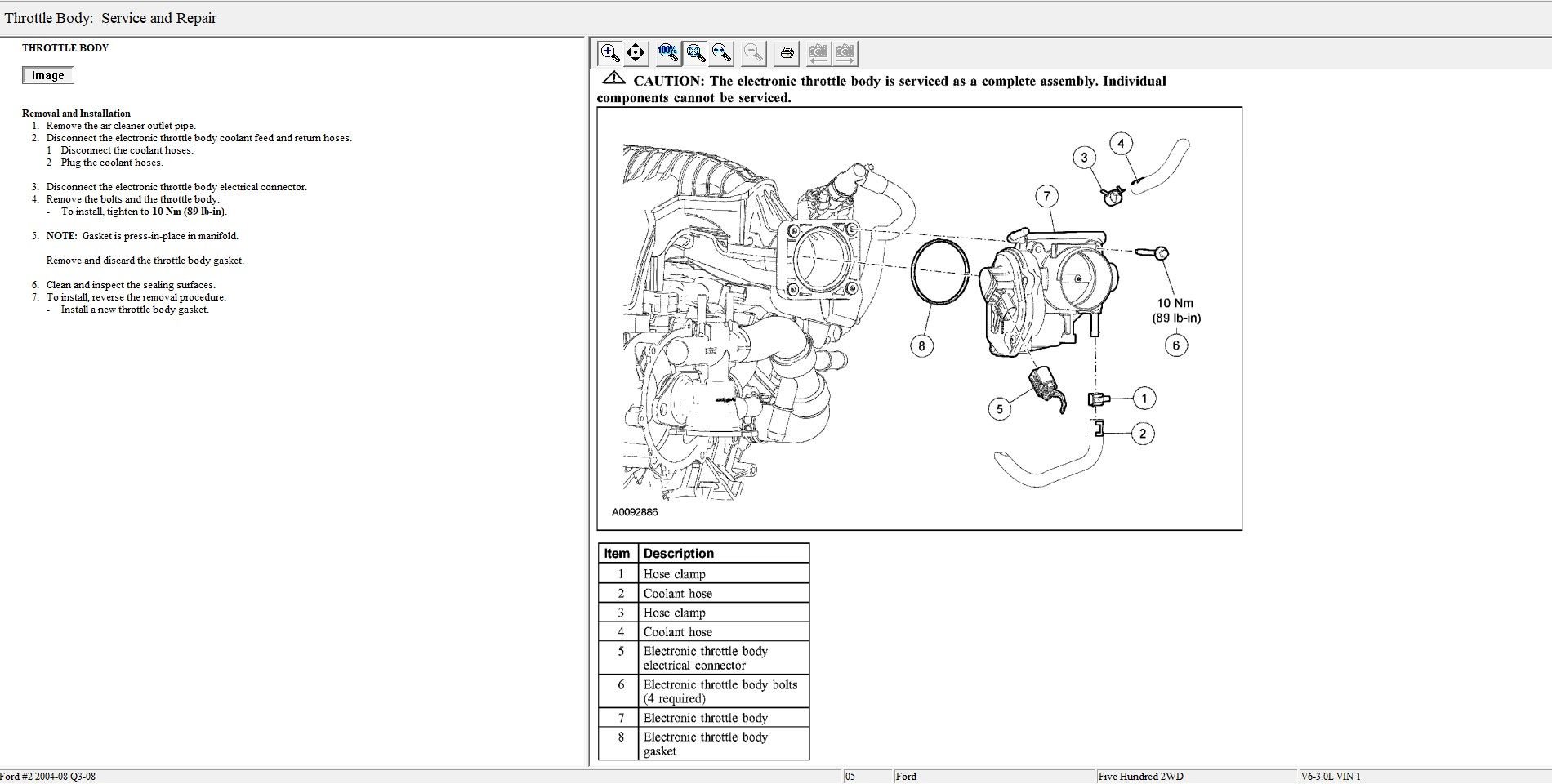

Remove and clean, I thought I mentioned this before already. Also don't forget to bleed the cooling system, and reset PCM adaptation (clear the KAM).
If cleaning the throttle body doesn't help, locate the IACV and clean that as well.

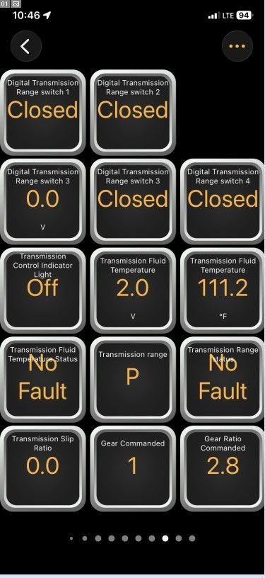

OBDLink MX+, unlike generic adapters, has Ford's specific DTC support, not just Ford but so many other car make. Check the list here -> https://www.fordforum.com/forum/ford...h-light-50915/
All included for free and not subscription based. Say you own a Ford, a Toyota and a Nissan, you can retrieve all OEM specific DTCs.

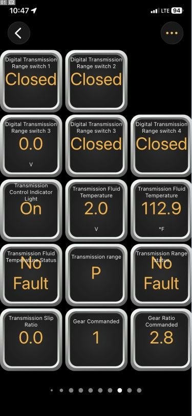

Examples on transmission only, there are hundreds more (if not thousands) to choose from:
If you compare the two above you can see "Transmission Control Indicator Light" first one is OFF the second one is ON, I done that on purpose so you can see, I simply pushed on the OD button on the stall on my 98 E-150.
