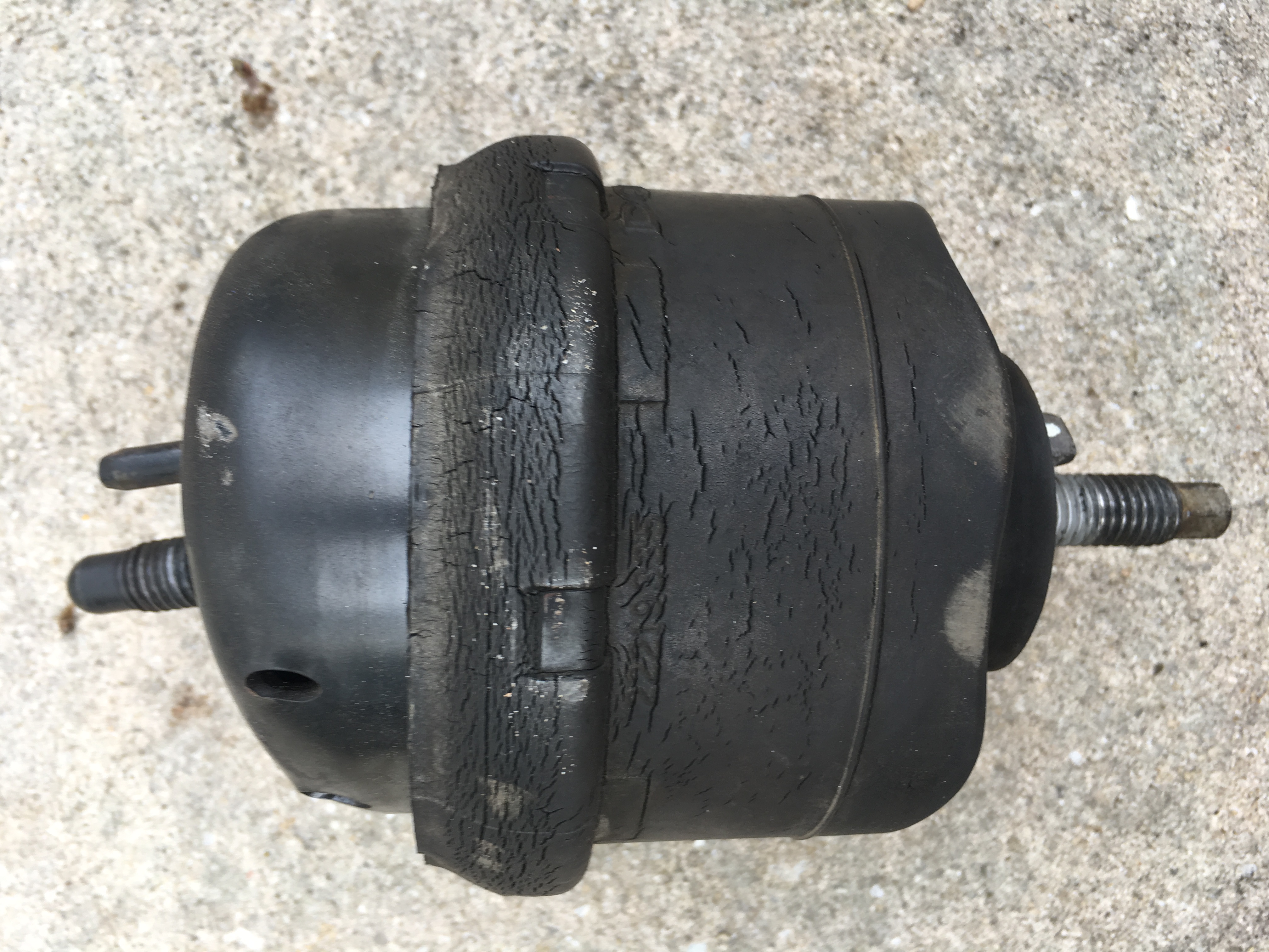

Old Jan 31, 2017 | 10:50 AM
  #20
thezebra's Avatar
Joined: Aug 2015
Posts: 8
Thumbs up Vibration during acceleration
I just replaced the rear engine mount and it SOLVED my issue with the vibration during acceleration as well as vibration at idle. Vibration was at 35mph with 1200-1400rpm. Vibration and almost felt like a miss at idle in drive.
To change the mount I raised the car on jack stands and chocked the rear tires. Removed the upper cross member support. Removed the rear catalytic convertor. Removed the 3 8mm screws from the rear mount heat shield. Jack up the engine using a block of wood on the oil pan. Removed the exhaust clamp to the from catalytic convertor to allow the engine to go up further. Removed the mount, move second heat shield that's on the mount to the new one and install. Reverse procedure to install.
Looking back I would have replaced the rear engine mount when I replaced the passenger side cv axle. When you raise the engine you can see that the engine has to go up but the cv axle is attached to the wheel knuckle. I jacked up the lower control arm because I was afraid I was going to damage the axle.
Overall it took me 8 hours to change this mount laying under the car. PITA.
