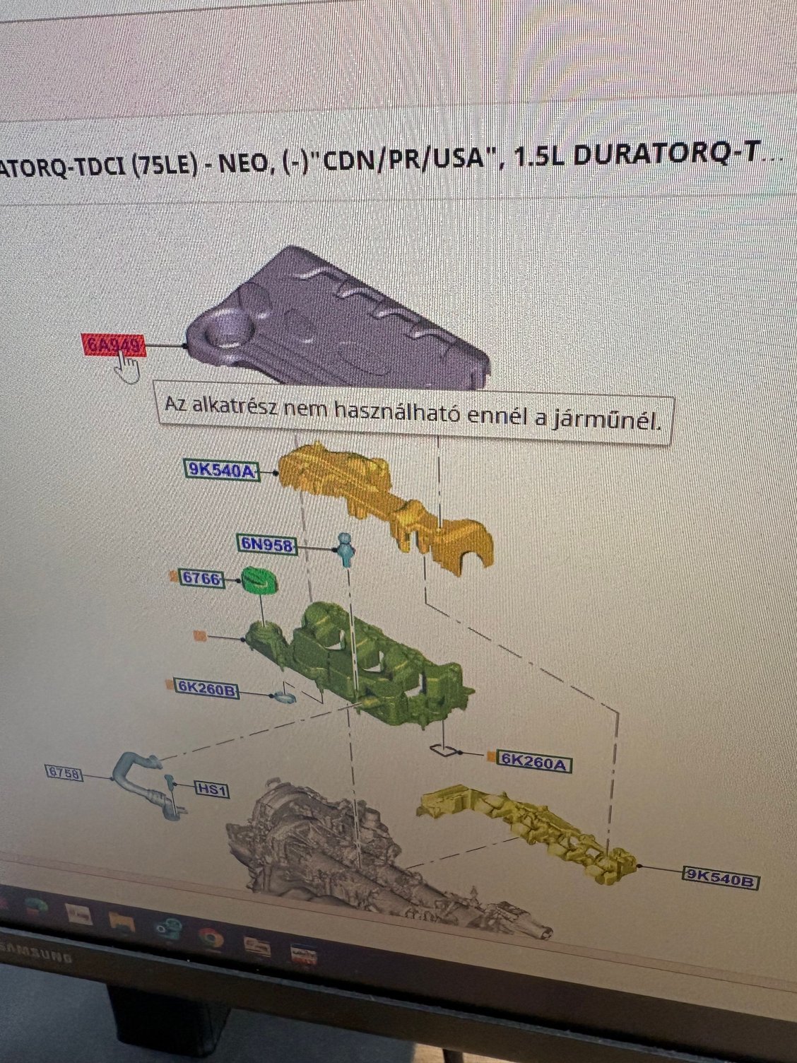

2. Does the engine block cover not exist for this model? (it wasn't on when I bought it)

2) Wherever you purchased your used car from, when the engine cover was missing and you didn't inform the seller for possible price reduction, you just have to buy it yourself.
