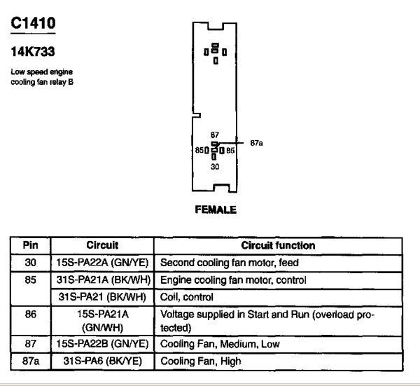

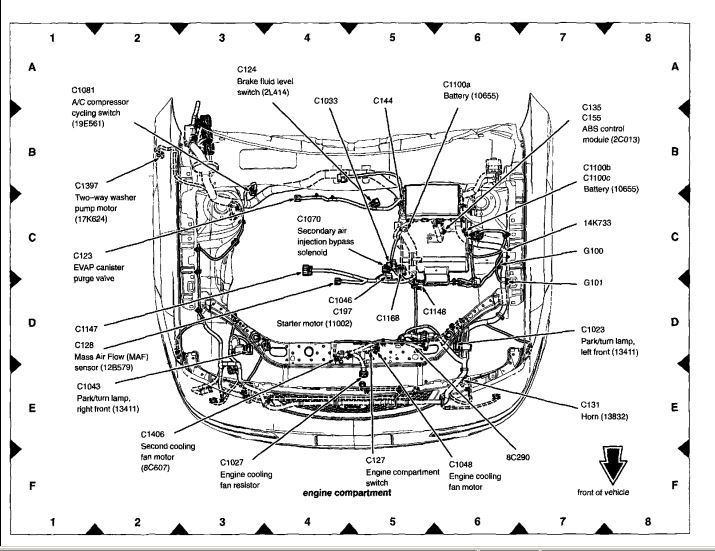

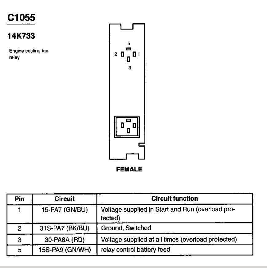

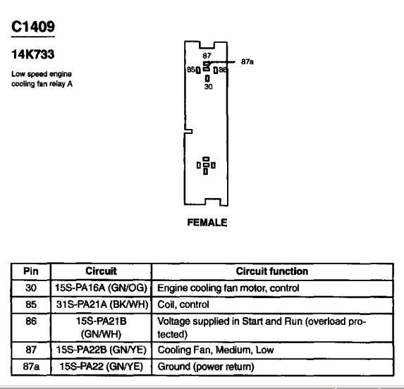

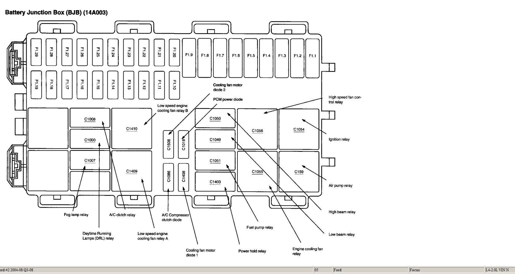

I have the fusebox shown in the diagram and picture, not precisely the same as the diagram as there is only one relay for the fan (marked with the red X) which I removed. It didn't make any difference, when I reconnected the fan it still ran, so that relay isn't affecting the fan control, so I replaced the relay.

Your car should have 2 fans and 3 relays.

Thank you Heiko. But, your information is not for the same version of the Focus. My car has the fusebox with the relays as the photograph. Also, the engine layout does not appear to be the same.

Only have US-Spec, don't have Euro-Spec. Check the wire color on the relays they should be the same.
