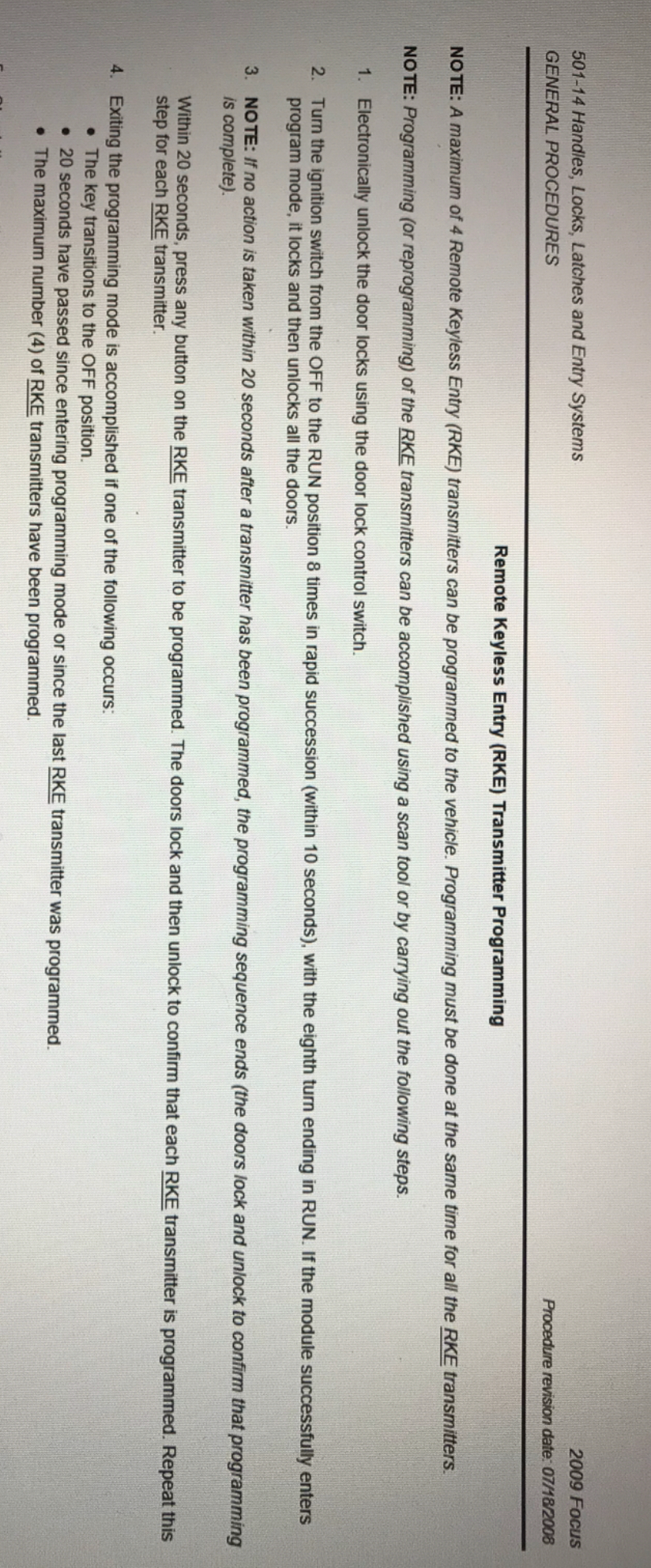

Old Aug 5, 2018 | 10:28 AM
2006 is a different procedure..
Attached Thumbnails Ford Focus 2009 remote programming-45556d08-4025-4b2e-a8e7-48a90ac07da6.jpeg
Old Aug 5, 2018 | 02:27 PM
Karam Sbahi's Avatar
Joined: Aug 2018
I tried those steps...nothing happen.
