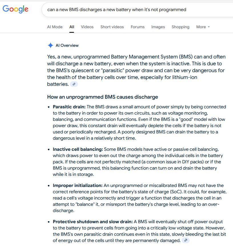

A BMS is a module so your PCM can communicate with, and throw DTCs (no check engine lights) when errors are detected.
Your old battery had a charging profile stored in nvm (non-volatile memory) inside your BMS like most smartphones as well as android head unit. When you changed out your old battery your old bms (without reprogramming) had no knowledge of the new battery change so the old charging profile would be used. Never forget there are people who buy a used battery because they can't afford a brand new one or they are selling the car.
Same can be said on a new battery and new BMS, your new BMS also doesn't have any knowledge whether you are replacing just the BMS alone or both, therefore you must reprogram it everytime you change battery or bms or both. If it's not programmed it's possible that your bms can discharge your new battery.
To program it you need a capable scanner like foxwell nt510 elite or use forscan. Without it you can program (reset) it with your high beam on/off several times and brake pedal in some sequences, search google to find out. There is no way you can reset your BMS by disconnecting your battery ground cable. Imagine everytime you take your car for service and the tech has to disconnect your ground cable and your bms gets reset, doesn't sound right. You reprogram it only once in a lifetime of the battery.
Before you reprogram it, you should use noco/ctek charger and full charge your battery so BMS agrees that your battery is new and not deeply discharged.
