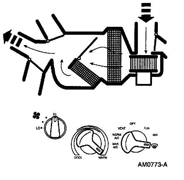

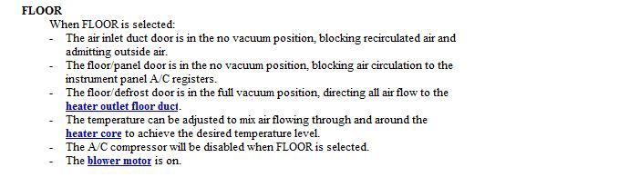

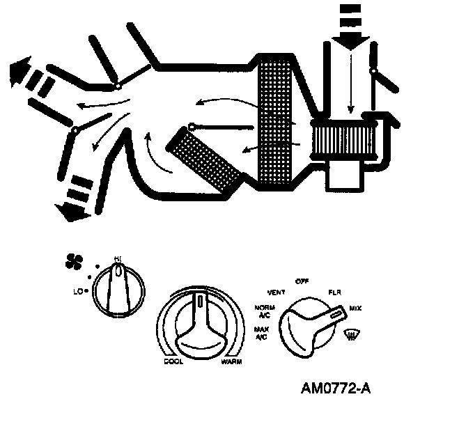

Old Apr 18, 2024 | 12:52 AM

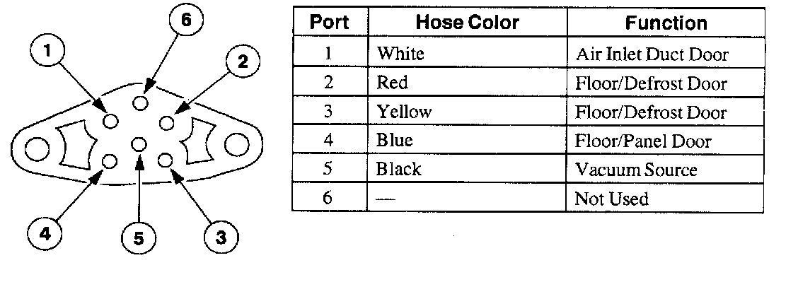

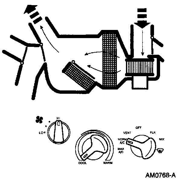

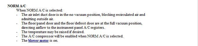

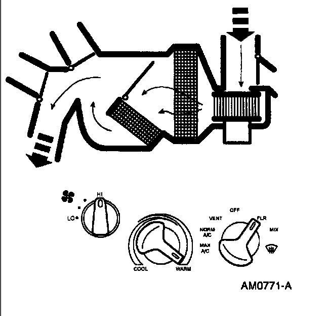

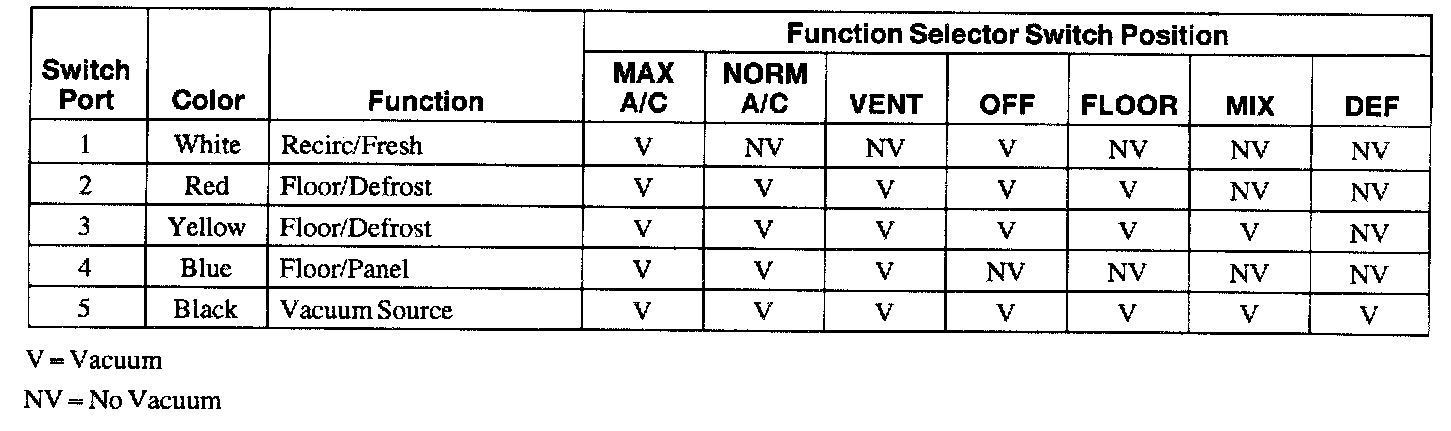

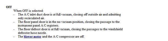

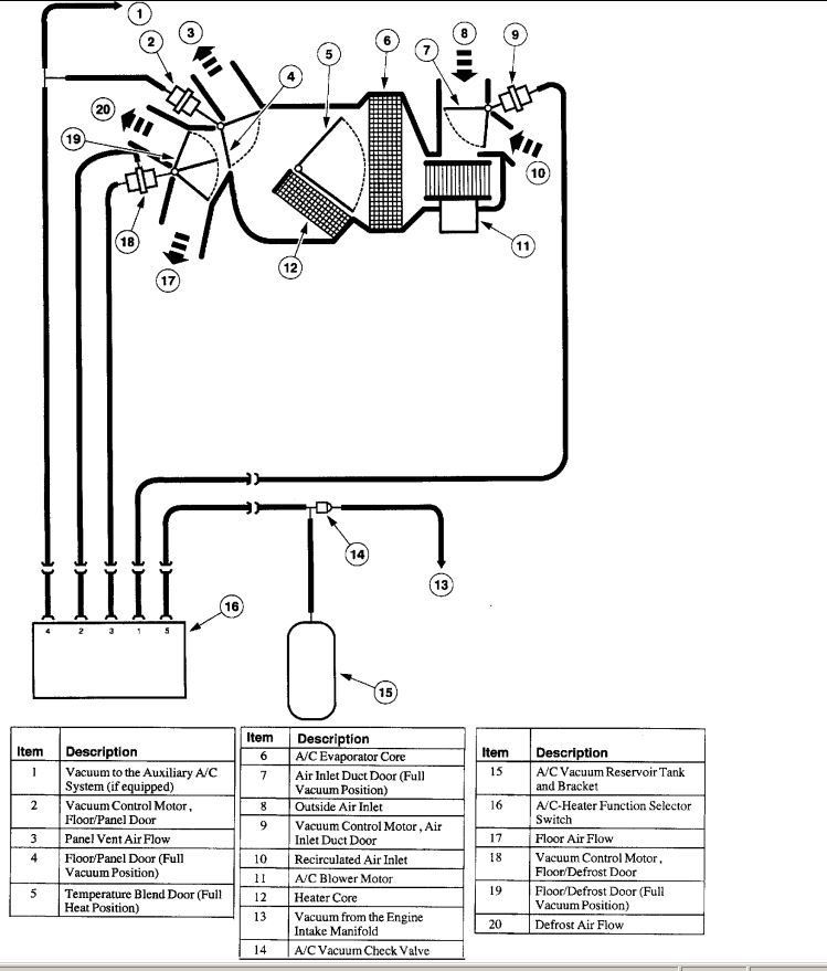

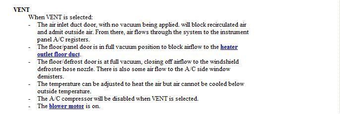

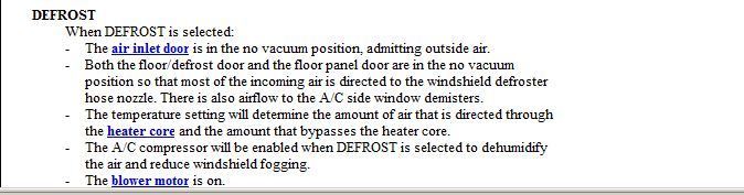

You said everything works fine in defrost mode so let's compare them:
Full vacuum or no vacuum in every selected mode:
You said vacuum lines are all good. All have vacuum.
You have vacuum doesn't mean you don't have a leak. Go over Pinpoint_A.pdf below for the proper way to test that.
If you think the switch is bad, check Function_Selector_Switch_Testing_Procedure.pdf (pretty easy continuity test) and Function_Selector_Switch_Removal.pdf

Old Apr 18, 2024 | 06:51 AM
Completeasshole74's Avatar
Joined: Apr 2024
Posts: 6
I replaced the check valve and selector switch. All good with vacuum. All control arms move to close and open positions. The vacuum reservoir has always been eliminated, due to being broken internally. It never bothered me too much when the air cut out in hard acceleration. But, I plan to add it back in, just been lazy about it. After going through the multiple test charts, the last one refers to repairing or replacing the damper door. That was coincidentally my first assumption after two days of messing with the testing and process of elimination. As I stated in my original post, I was able to push open the damper door through the foam duct seals in the Pic provided. My assumption is it won't go back, because it is detached below, where I can't see, or off track. Not sure about it's mechanics. Thanks for all the charts and info.
