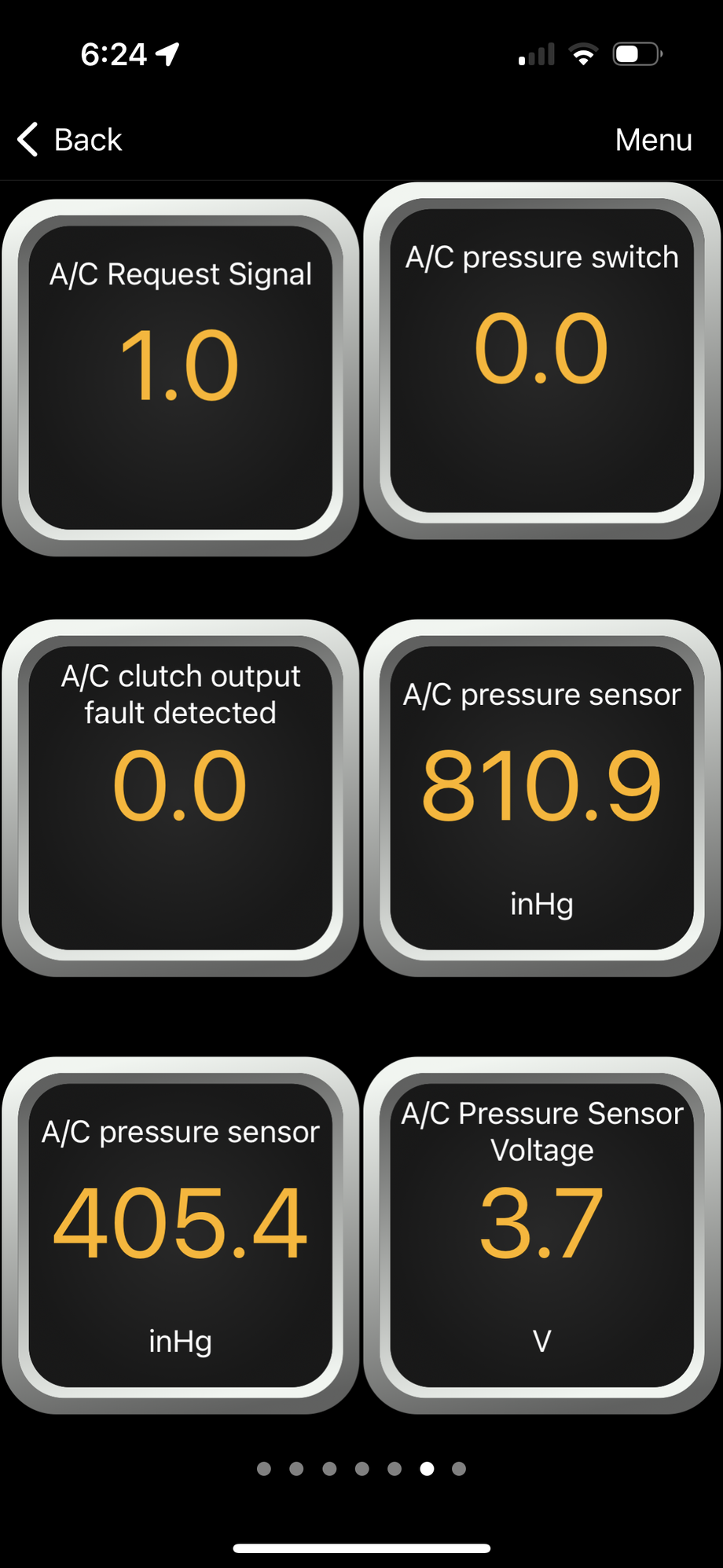

Pull
Pulled These codes from the enhanced diagnostics. Not 100 percent sure how to interpret or if there is enough information here to tell anything.
Old May 27, 2024 | 06:15 PM
You checked the low press sw and found it to be open. Do you have power to it? A refrigerant charge that is too low to close the sw could give the problem you presently see.
The majority of the time, the A/C relay just handles the high current the magnetic clutch on the compressor requires .The relay needs to get it's signal from the pressure sw circuits.
