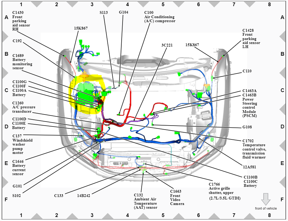

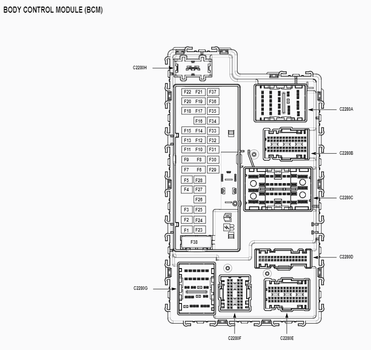

Here is the battery junction box and the body control module along with their location.
PM me your VIN and I can run it through FMC.

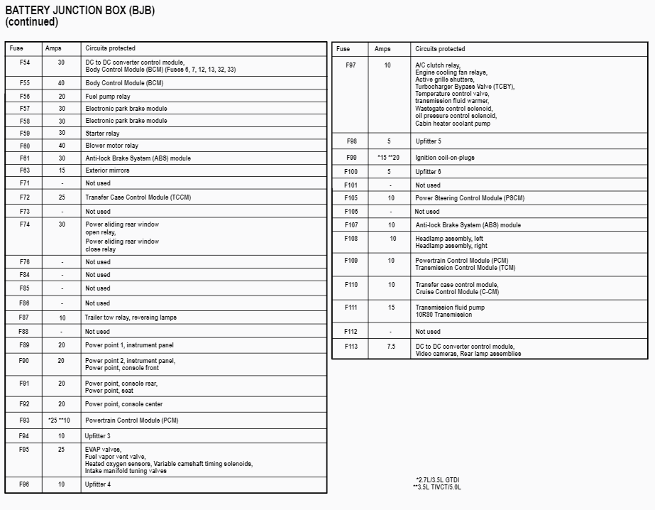

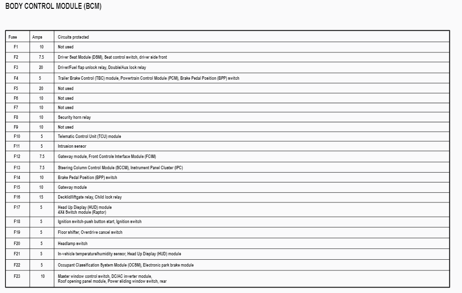

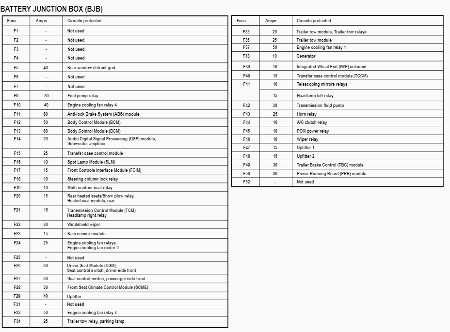

Here is the breakdown of what each fuse does for both fuse boxes.

I am looking for a way to shut down the interior lights,= Fuse. Last week after a freeze up the doors froze shut (-25C) and only one door opened,long story short,i damaged the latch lock and now the door will not close all the way leaving the interior lights On while driving at night and when parked.I have managed to duct tape it tight enough to shut off lights when parked but once in awhile when driving the lights come on . Parts are ordered for delivery in the new year. I must have the USA owners manual because it shows the BCM fuse #1 is for dome,courstey ,inside lights and there's no fuse.
Looking at the info you sent me I can't see such a fuse anywhere for the lights at the BJM or BCM,,I looked 3 times..So i guess it's up to the dealer to help me until the parts arrive..Thank you for your time, once i solve the issue I'll post what i find out
