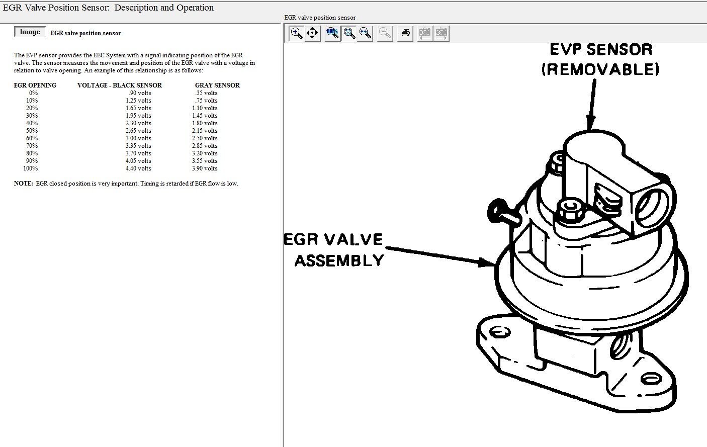

A little FYI, be careful if you decide to replace that EGR sensor mounted on top of the EGR valve. Those little bolts have been heated and cooled many times and when you try to remove them the heads break off and now you will need to replace the entire valve assy and will need new little bolts to secure the sensor to the valve assy.
