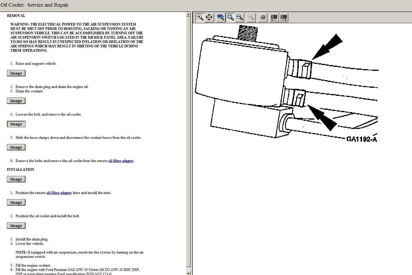

Not sure if these help any.
3 more PDFs attached below.
