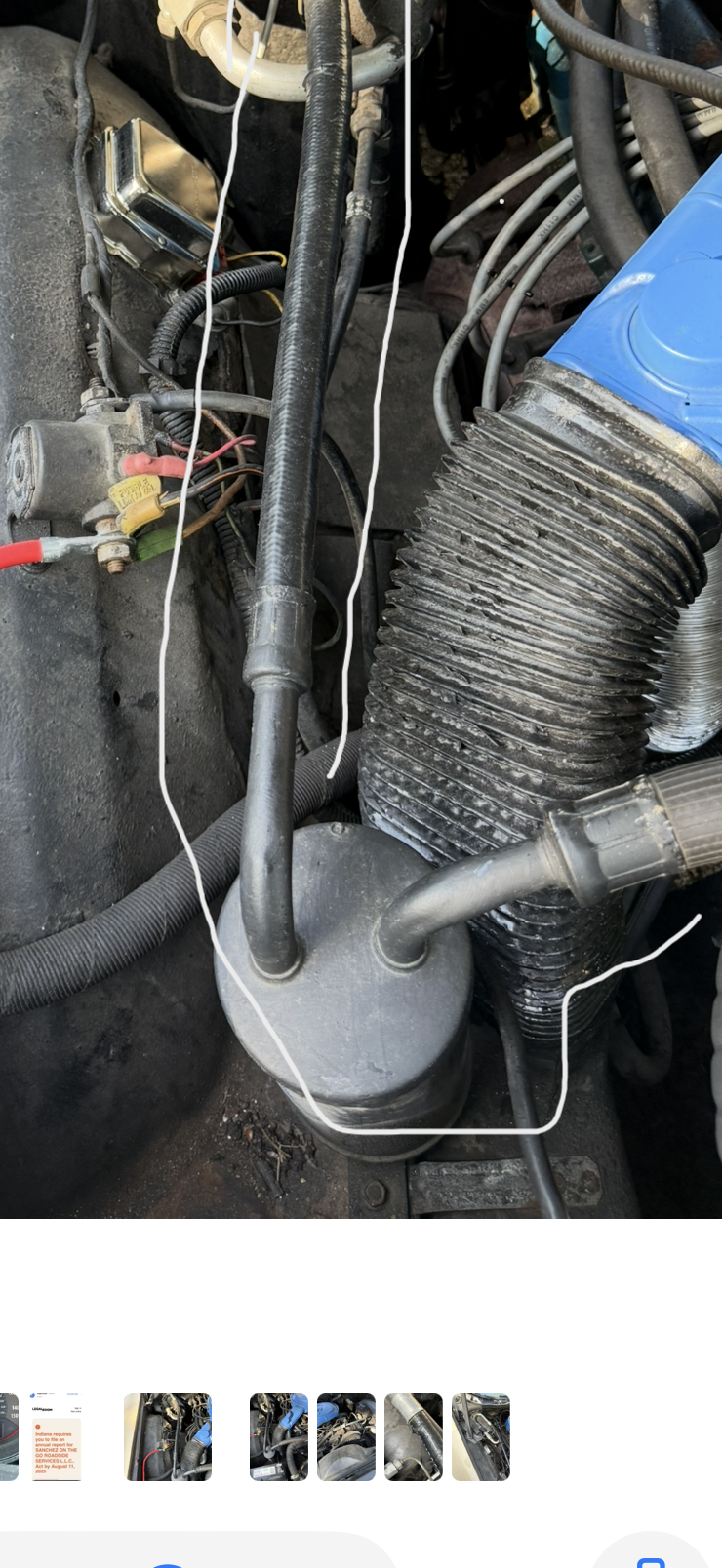

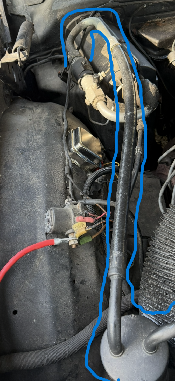

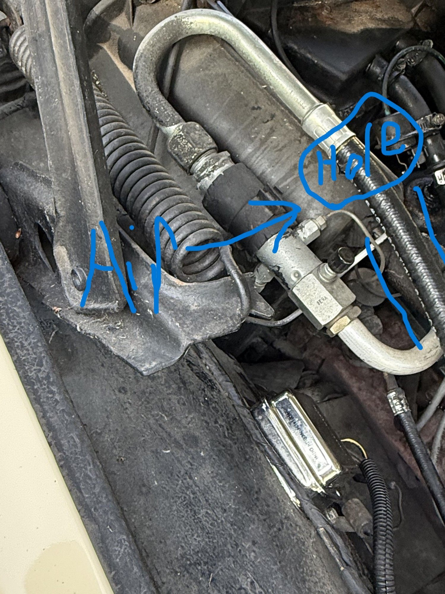

help with air contion hose how to fix or somewhere to repair.

1978 ford t-bird
351 W

There is no easy way to fix this.
The metal can that hose is attached to is called an accumulator and will need to be replaced because the hose is part of the can.
There is a lot of work involved with that job and best to leave it with a professional air conditioning shop or dealership that would have all the necessary parts.
Get estimates before giving that job to a shop,it won't be cheap !
