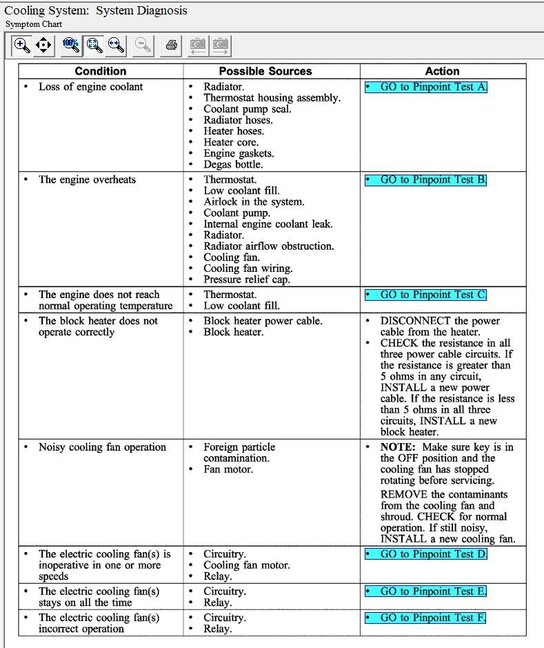

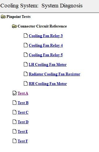

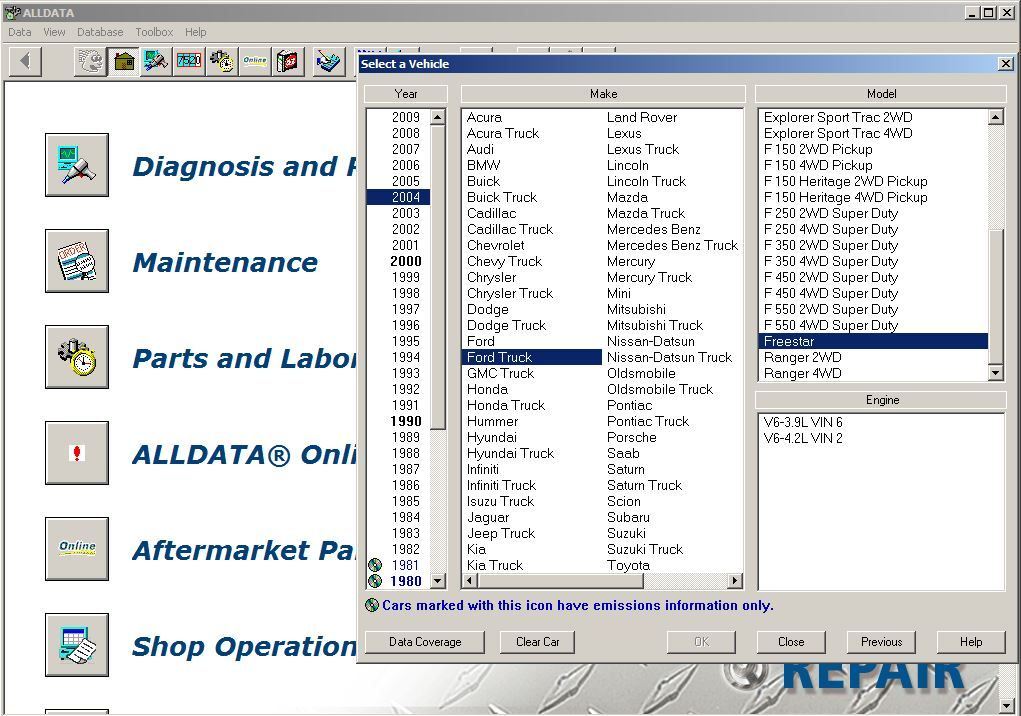

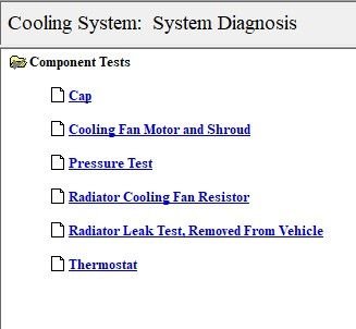

Old Feb 27, 2025 | 01:05 PM
Posts: 1,283
