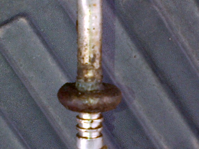

Well, looks like I have another project on my hands which may help others with "No A/C" issues. Went to fire up my A/C (was a little warm in the van yesterday), and what do you know. No cooling. Hummmmm...Wonder what the problem is. Popped the gages on and what do you know, no pressure in the system (has to be a leak somewhere). Put the nitrogen to the system and what do I hear? Hissssssssssssssss from the rear. Quick look and there it is. Low Side like leaking at the quick connect (picture included). Guess it's time for some new O-Rings on the High and Low side in the rear (hope my hands fit ). May as well check the rear in-line filter on the high side while I'm at it.

Nice pix, got your work cut out for you!

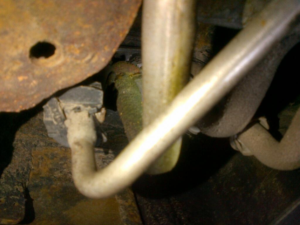

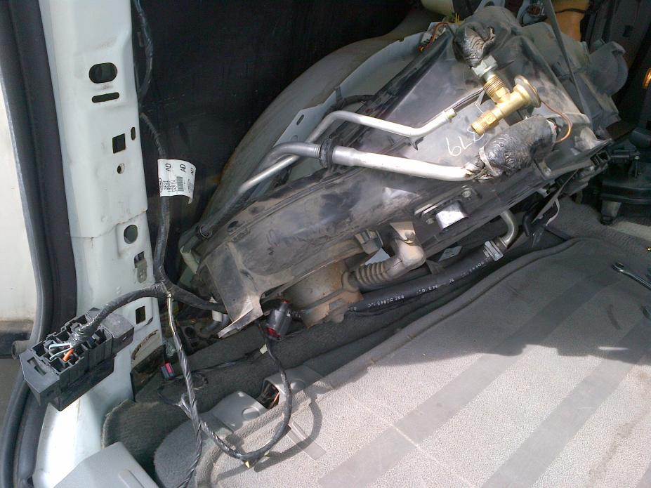

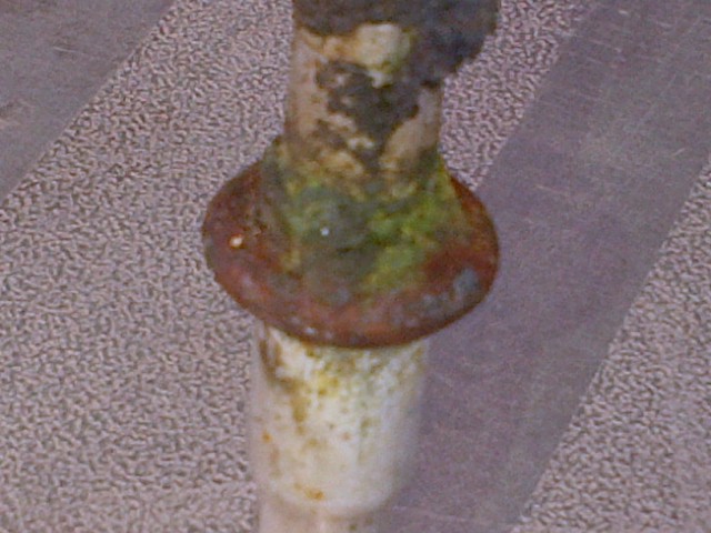

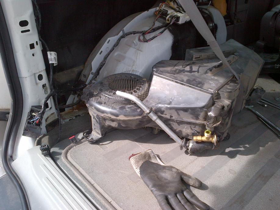

Update: Unbolted the rear unit and swung it down to pull the suction line off. Also removed the liquid line. Good thing that the suction line was corroded and would not release. Found that the line is actually corroded thru just above the disconnect fitting. Checked the liquid line and it's soon to follow, so I just ordered one of those from ROCKAUTO.com
Here are a few pics of the rear unit swung down for access and the lines showing the corrosion.

Update: Received all of my parts and installed them. Reassembled the rear HVAC unit. Since the system was empty for who knows how long and I had it open for about a week, I pulled a vacuum and then vacuumed for another 2 hours. System held the vacuum for 1 hour. Added refrigerant and both front and rear units are cooling great. 87° ambient outside temp, 93° inside the van and 45-47° coming out all of the front and rear vents. Now, if I can only get the gremlins to put all of the tools away...
