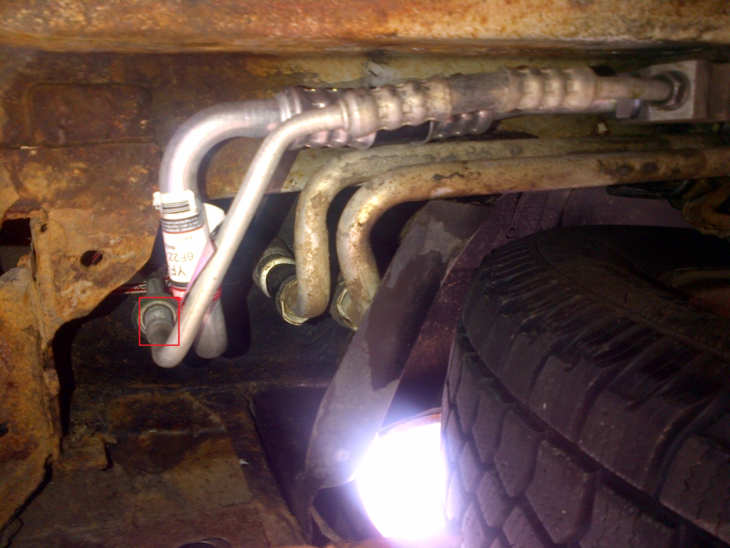

Just to help, here is a picture of the rear liquid line where the factory in-line filter (Marked by red square) goes.
Attached Thumbnails No A/C - Blown O-Ring seal-freestar-rear-a_c-filter.jpg

Thank you very much. I would rather replace it now and get it over with.
I found it on ebay for around $6. Is there a special tool to get that fitting loose there, or do you just remove the clip and pull it apart?

You use a standard A/C Quick Disconnect Tool. You may also need to remove the line from the "Y" block to get the line to drop down. That's what I had to do. I would also use new O-Rings. The end that has the filter in it takes 3 O-Rings (7.37mm x 1.81mm). The "Y" block end takes 1 O-Ring (12.93mm x 1.86mm). I found these to be cheaper at Ford. Make sure you coat the O-Rings with some PAG oil to help them slide into and seat better in the fittings.

That line apparently needs a 1/2" quick disconnect tool. I bought the smaller set but 7/16" is as big as it goes. It looks like the line enlarges there from 7/16" to 1/2" to allow the filter to fit.

Thanks for your help, I'm glad I checked that rear filter, it was 100% plugged, just like the Orifice filter.
