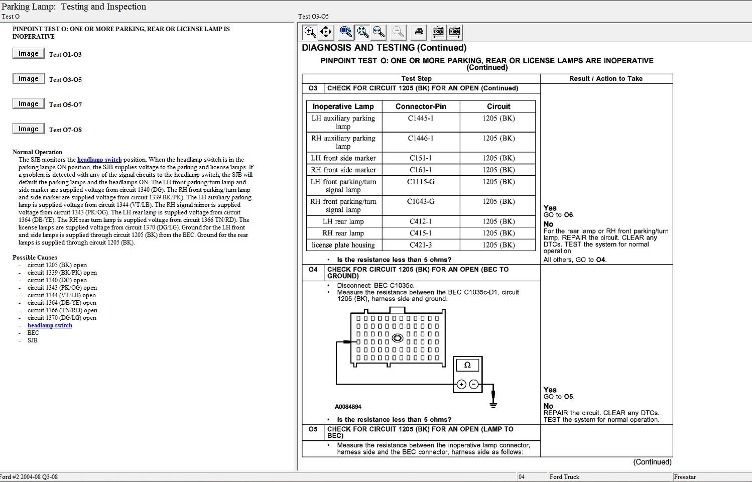

If you have a scan tool/FORScan, please provide the DTC here. Here's Pinpoint O, if you need to see the diagram of a particular connector or circuit let me know the number.
