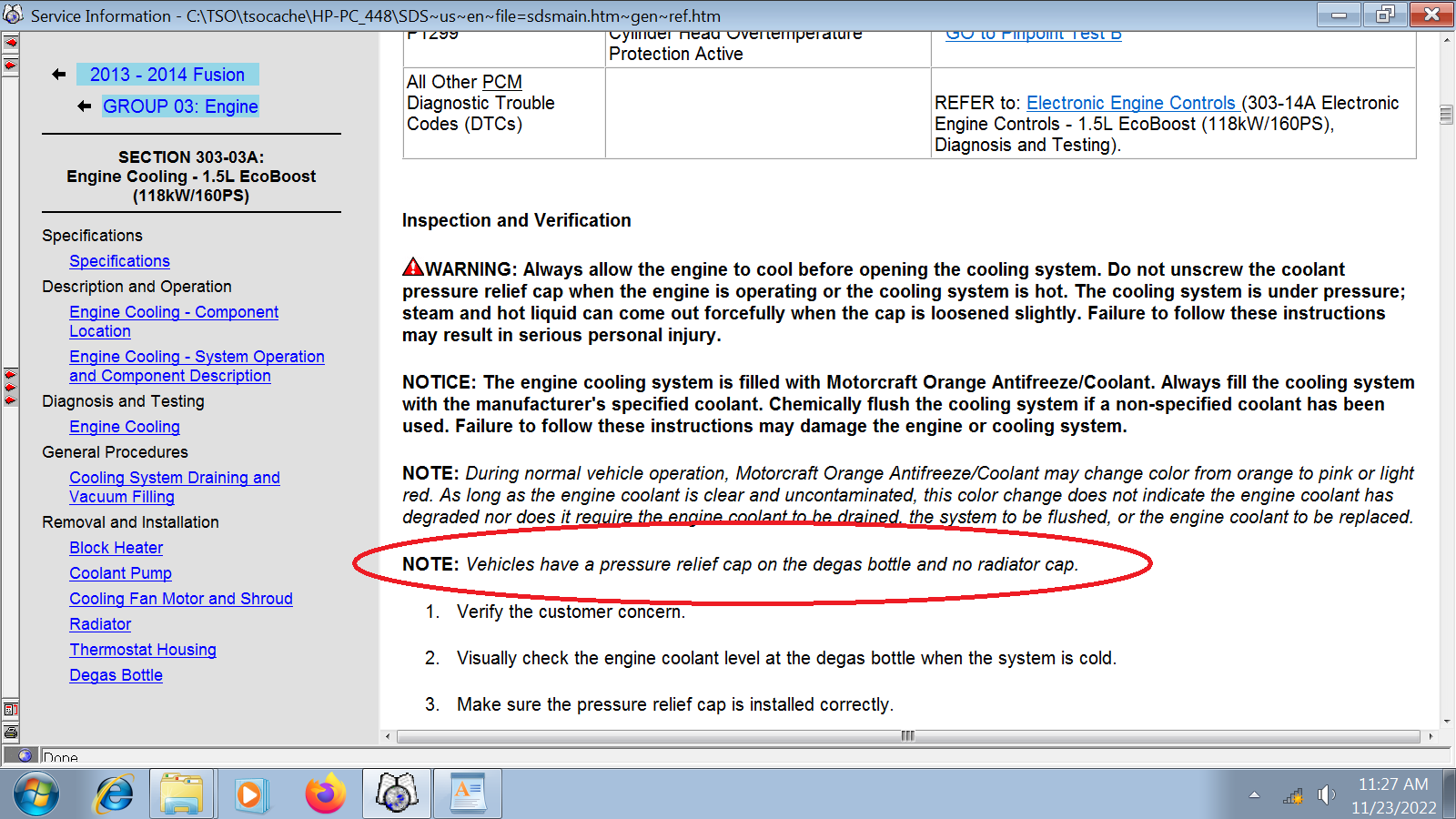

We see what we want to see and it didn't register that a pressure reading was attempted at the degas bottle.
The kits and adapters are to pressurize the radiator and not the degas bottle because the degas bottle is vented to the atmosphere whereas the rest of the cooling system is pressure controlled by the radiator cap. I believe you are testing pressure in the wrong place.
Old Nov 23, 2022 | 01:29 PM
JimPinVa's Avatar
Joined: Nov 2010
No, on the Fusion, the degas bottle serves as the location for the service fill.
Old Nov 23, 2022 | 02:04 PM
Thanks for bringing that to my attention.
