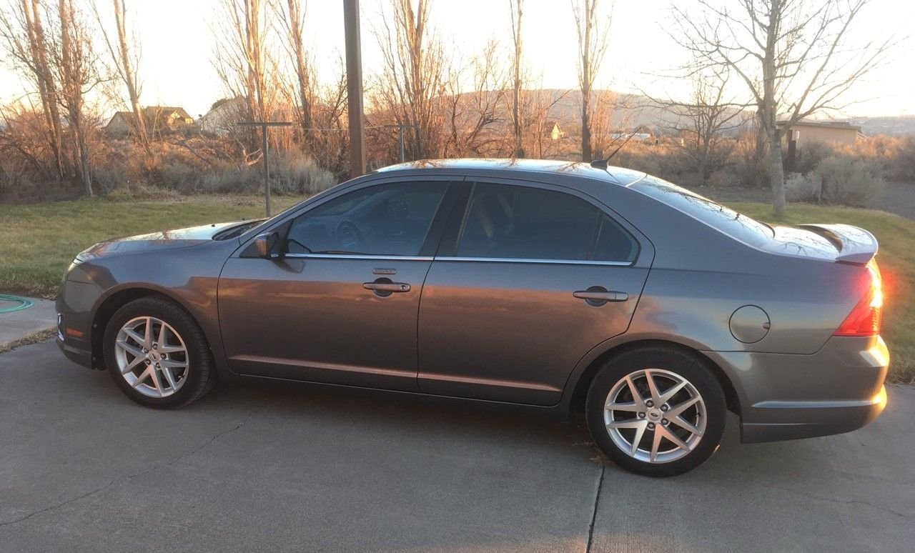

Just acquired a clean one owner 3.0 liter V6 powered 6-spd auto FWD Fusion with 139K miles, leather and sunroof - etc., and am happy in first week of ownership. Drives great, shifts smoothly, suspension feels still tight, everything works (except the keyless entry). I'm going to keep this car for a long time.
It's my 2nd very clean used Ford in three years (after a 2006 Ford 500), so I guess I'm switching my favoritism to Ford. I'll have to get to the dealer (local, where it was purchased) to find out how / what's wrong with the digital keyless entry system because the original owner didn't know - said he'd never used it.
My questions:
1) Tranny. The owners manual calls for first tranny fluid service at 150K. This car has 139K, and I intend to have dealer do this service within weeks because I want to keep this tranny working smoothly, repair free. So, any info / experiences / suggestions as to whether flush service or a drain and fill would be better for this 6 speed auto?
2) Prior owner took car to various places for oil changes, likely plain jane syn blend or dino type oil. No evidence of oil consumption. What kind of oil do owners of this engine use; not asking for a debate, just some input points. 5W-20.
3) Spark plugs. Original plugs are still in place; how many miles do these last for - in practice?
4) Problem avoidance. What should I look for or do to avoid maintenance issues; I can follow the manual, but what breaks first?
Thanks for your input, guys!
Clean engine compartments always look good!
No dents or blemishes.
