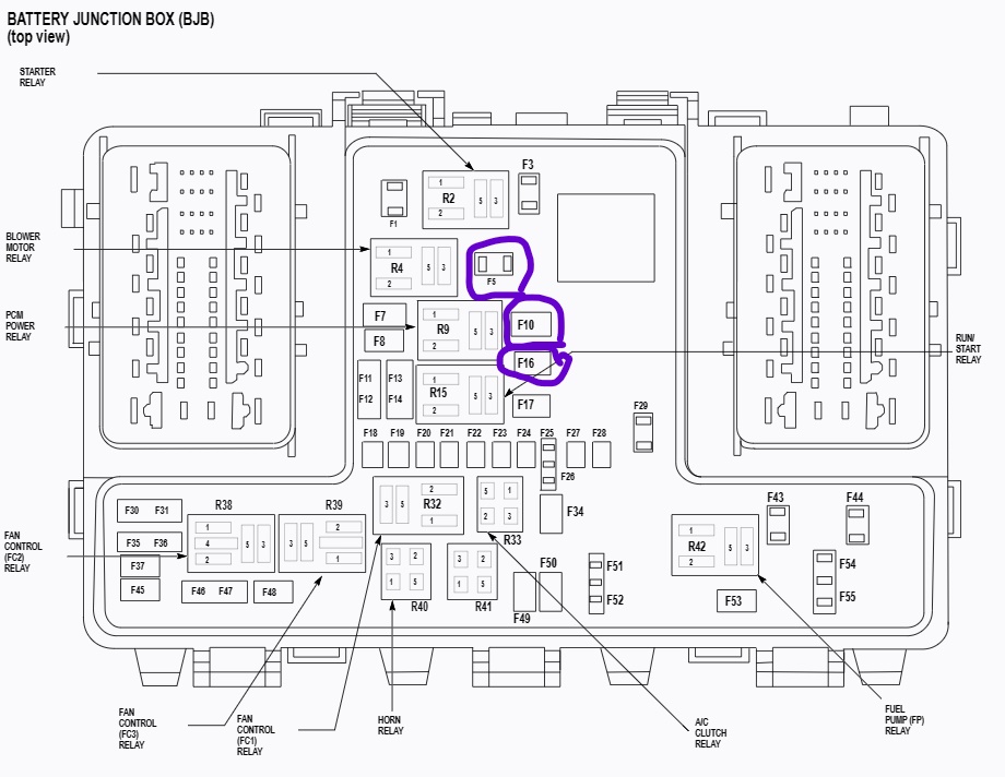

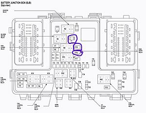

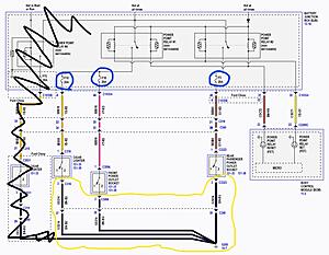

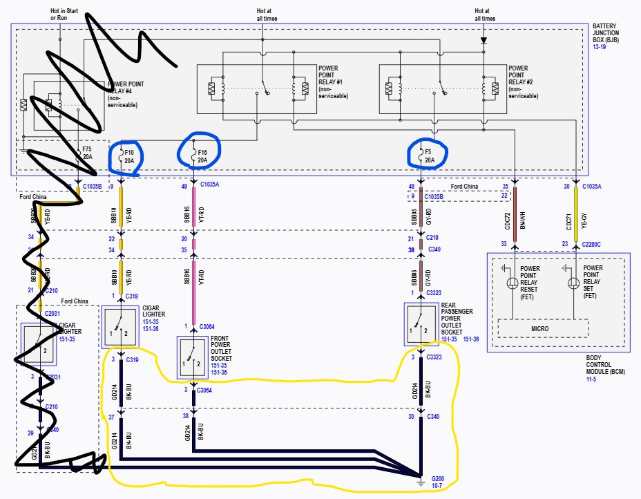

Here is the wiring diagram for the power ports. I crossed out the part for the China models have. Since all three are inop we are looking for a shared point. Unfortunately the relays for the power points are internal so you cannot access/test them. Start with checking for resistance of the ground from the power point, then check for resistance from the fuses to each respective power point. You can check if the three fuses are blown, it's unlikely but worth a check.
