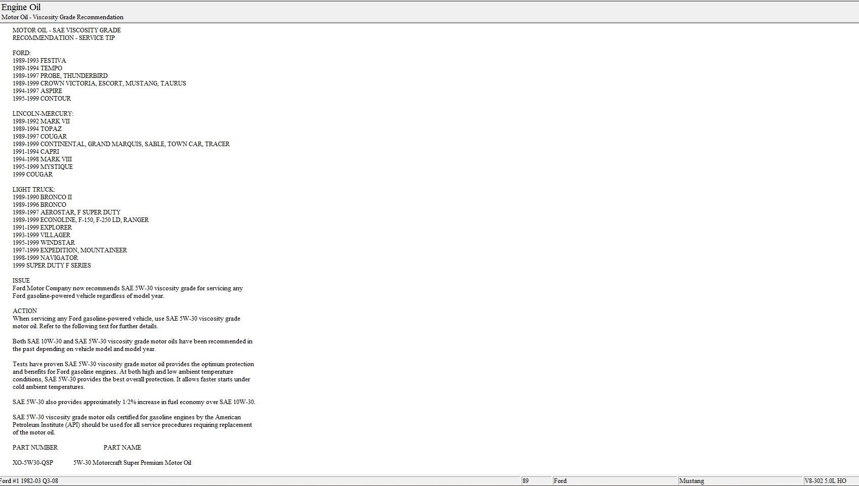

I'd use Mobil 1 Extended Performance High Mileage full synthetic 5W30 no reason to switch to 10W40 if it doesn't have high oil consumption (burning oil).

Thank you for providing what the Ford Motor company is now recommending on oil viscosity. Good Stuff!
