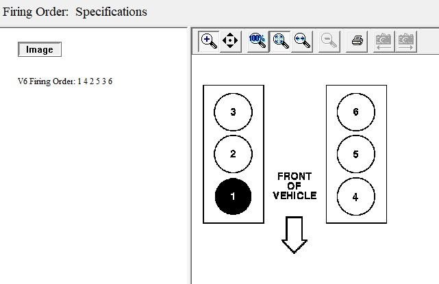

Suggest you verify the spark plug wires are connected to the proper coil towers ,they DO NOT CONNECT as one would expect, ESPECIALLY NUMBERS 5 &6. WHICH ARE REVERSED.
Old Mar 5, 2025 | 07:26 AM
Type in "Ford spark plug wire connections on coil". for 4.0 engine"

Thank you again for the reply. The spark connections are all correct.
Old Mar 5, 2025 | 04:09 PM
Were you able to see AND trace the wires for cyls 5&6 and their location on the coil ?

Yes. The 5 an 6 wires are properly connected to the coil tower.
