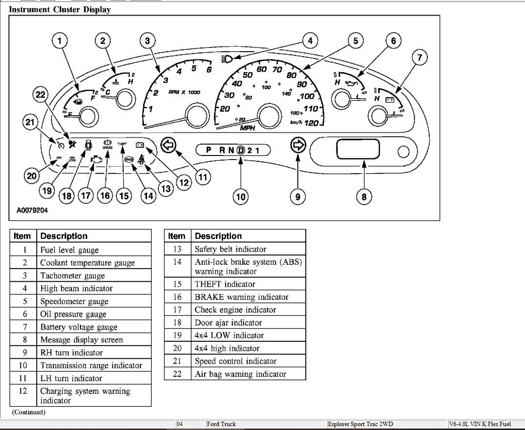

Old Feb 10, 2025 | 01:29 PM
Which item, 2 + 7 + 8 or 6 + 7 + 8?
Temperature gauge should be all the way left when cold.
