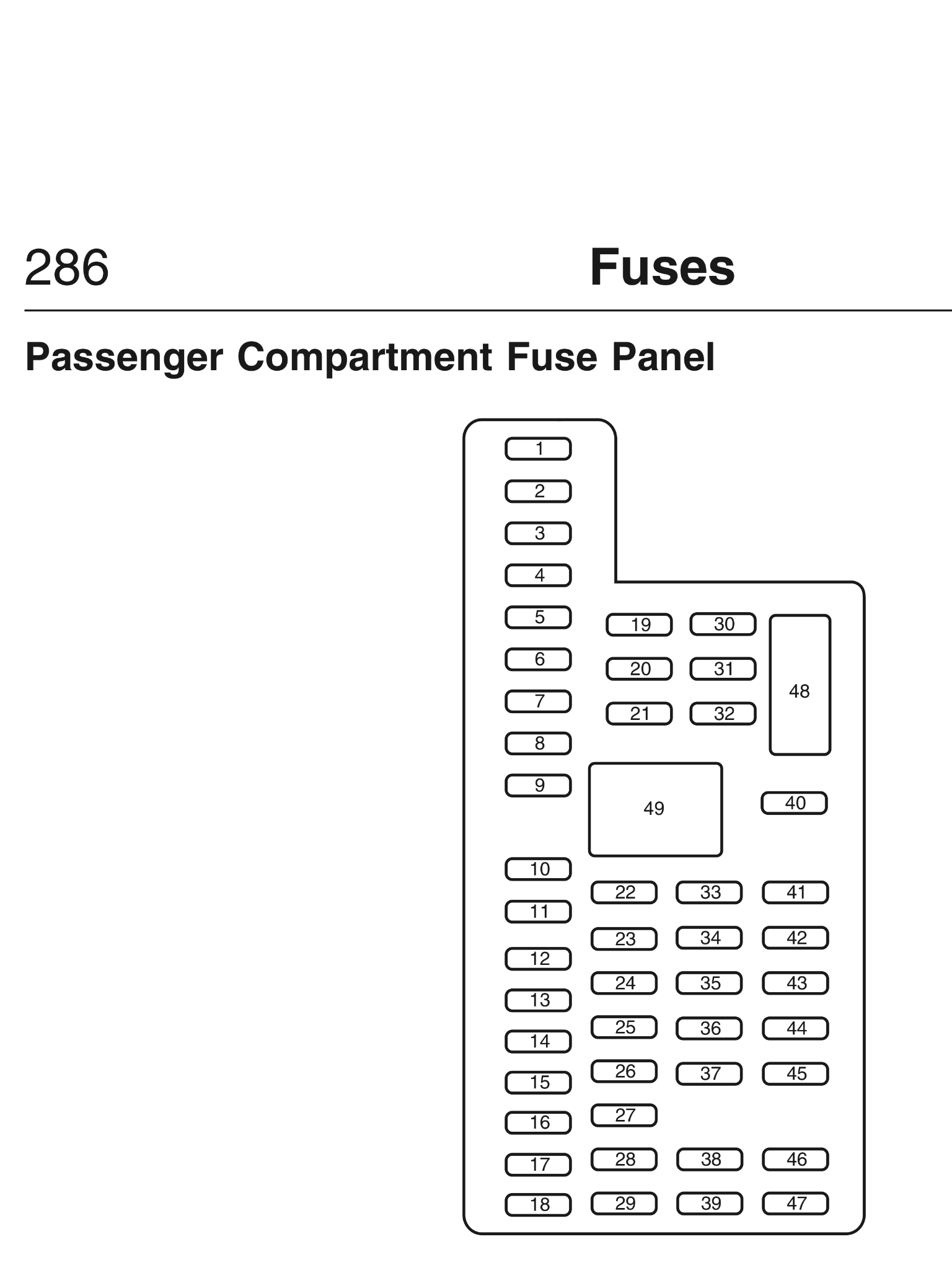

Fuse for the DLC (data link connector) is in the Body Control Module..
Fuse is position 'F.24' and is a 15amp fuse.
If equipped with a Power Tilt steering column,, and its functioning, the F.24 is good since the Steering Column Control Module shares the fuse with the DLC.

i checked the fuse for the power tilt steering wheel and the "cigarette" lighter too, both fuses are good. the power tilt steering wheel works and the "cigarette" lighter will charge my phone just fine. any other thoughts?
