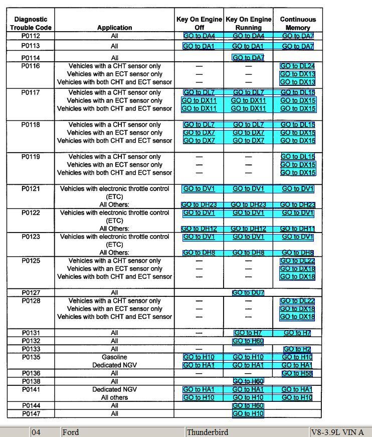

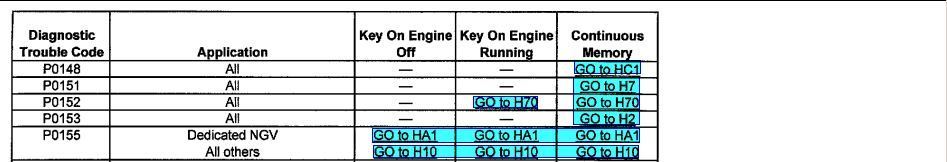

If you see the circuit problem then it's the wiring issue and not the sensor itself.
