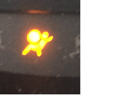

One issue I cannot seem to resolve and it may be my lack of understanding. the story goes, someone backed into it in a walmart parking lot and it deployed the passenger seat airbag. I went to the junk yard with an understanding they are interchangeable with a seat that has no airbag as it use a yellow delete end cap. The wires on original seat and scrap yard seat looked exactly the same. It still flashes a 37 code even with battery out for other repairs for a week. I found this: https://airbagcode.com/ford-2000/37 but it does not seem helpful as I see no diagrams or pictures. I' a picture kind of guy...

5 or will the module just need a reset? I can clear it with my maxi303 but it appears to be a hard fault and flashes a code right away after clear.

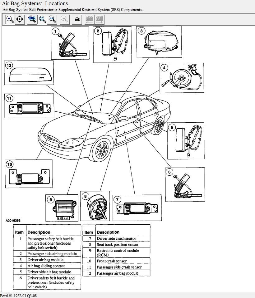

Also check the two pdfs below.
Old Sep 23, 2024 | 01:04 PM
knitefall's Avatar
Joined: Sep 2024
heiko
I thought the PDFs might be instructions. It only describes checking a seat belt and that memory needs cleared after impact. Now if there are procedures etc.
