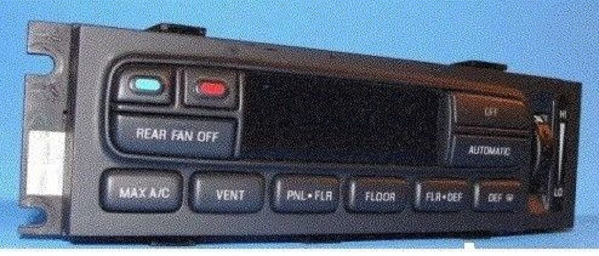

I tried to find what Fuse 114 goes to and in the process found your vehicle could be equipped with Automatic temp control (EATC). I wrote what is below before finding that. If you have EATC the below doesn't apply. Just let me know I'm leaving an attachment for the diagrams and what an EATC control head looks like.
It will say Automatic under the OFF button
