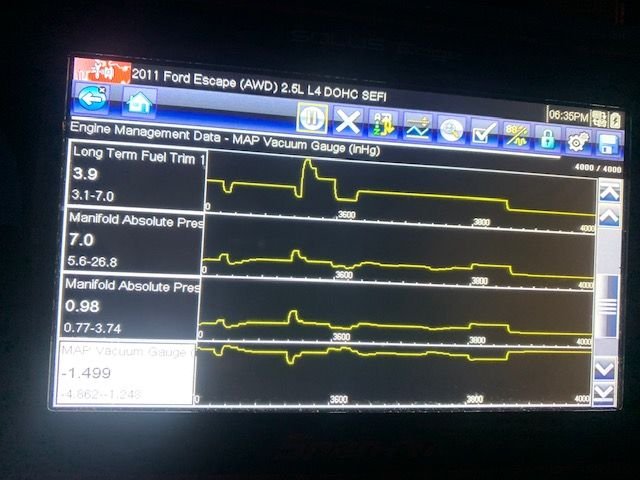

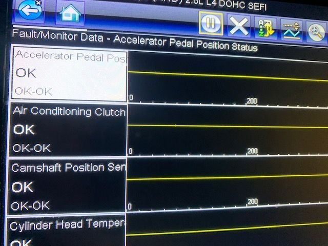

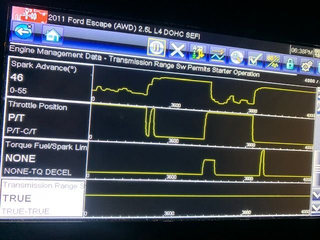

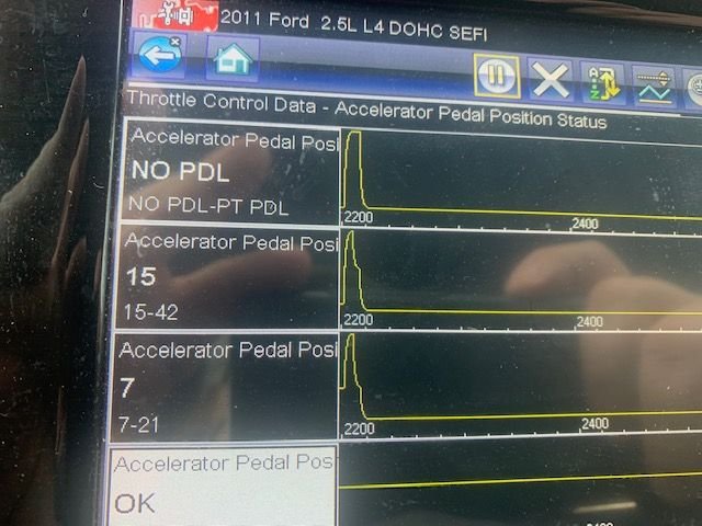

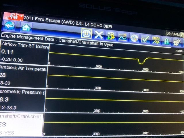

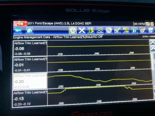

Can you post the data stream readings , (RPM, coolant temp, fuel trim,TPS, all the data it can provide at idle and at 2500 RPM ?
We may be able to spot a problem if able to see that info.

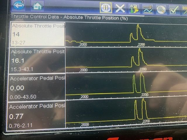

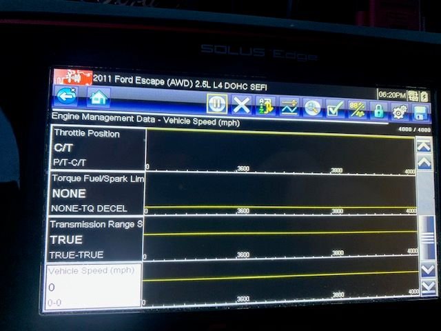

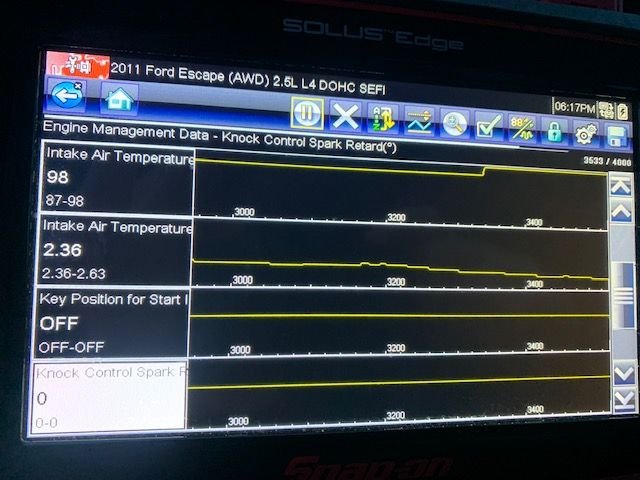

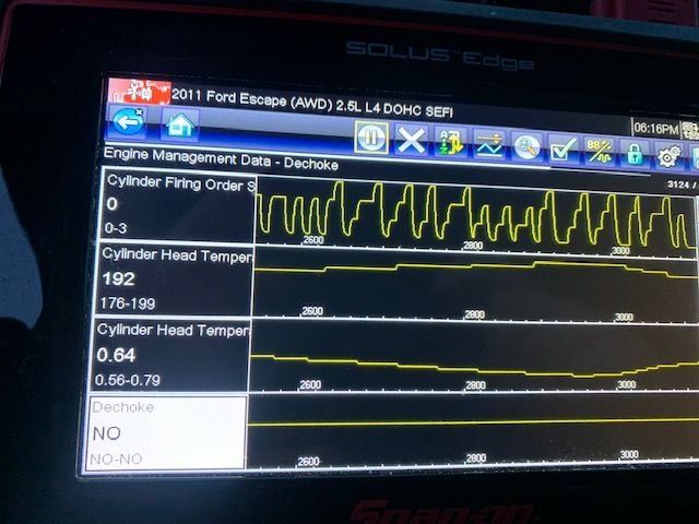

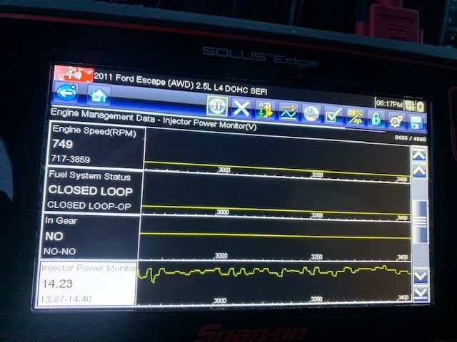

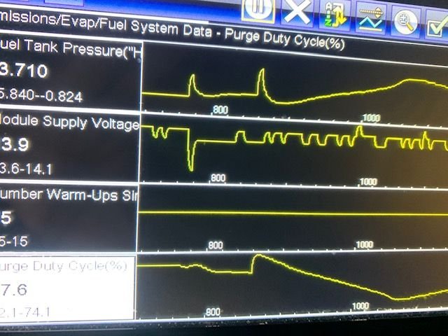

Old Mar 3, 2020 | 10:21 AM
ksbs's Avatar
Joined: Dec 2007
Posts: 15
From: Manitoba Canada
Default ford escape
Old Mar 3, 2020 | 10:33 AM
ksbs's Avatar
Joined: Dec 2007
Posts: 15
Default ford escape
Old Mar 3, 2020 | 10:34 AM
ksbs's Avatar
Joined: Dec 2007
Posts: 15
thats all at idle if that helps now i will send u at around 2500 rpm

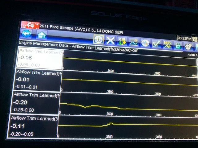

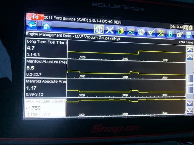

Old Mar 3, 2020 | 10:49 AM
ksbs's Avatar
Joined: Dec 2007
Posts: 15
Default ford escape
Old Mar 3, 2020 | 10:51 AM
ksbs's Avatar
Joined: Dec 2007
Posts: 15
hope this helps short term fuel trim does not seem right
