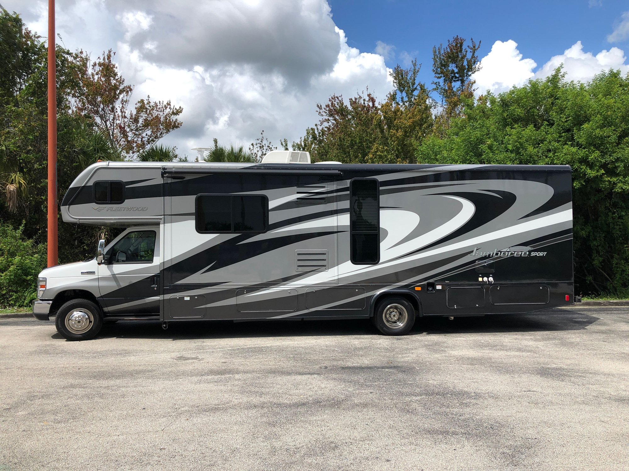

New to the forum. I have the above mentioned chassis for my class C RV. 9k miles w V10 gas. Recently it developed seemingly overnight a security/no start issue. Took it to my regular mechanic, and he traced it back to fuse box in the engine compartment, but couldn’t identify what was causing the problem other than a potentially intermittent loose wire, but sometimes the damn thing won’t crank at all with the security light flashing, other times it’ll fire right off.
whatever the problem is is also tied to my slide outs and backup camera. Because they all work/don’t work at the same time. Juggling the wires going into the box sometimes works, but most of the time, nada. I had heard that these fuse boxes have inherent issues and often need replacing. Anyone else have these issues? It’s not like I’m beating this thing to death with 9k mikes in 6 years. Pic for attention. Thx

Nice toy !!
